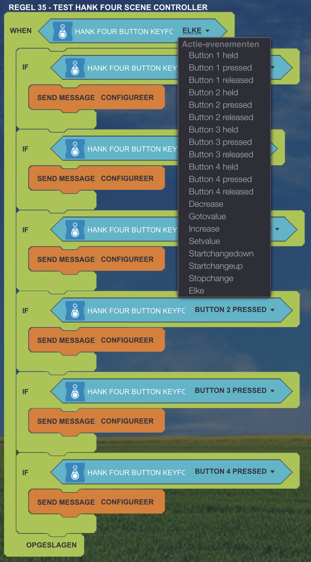

new to zipato and trying to include the Hank Four Button Keyfob into a rule.
I can set up associations for all 4 buttons but when try to include it into a rule I don't see the "buttons". Any suggestions how to make it usable?

I have the same scene controller with FW version 1.5.
Zipato support helped me to support this device.
Did you include the device from a very short distant? I include everything from a distant of a few centimeters.
See my options in the rule creator.
