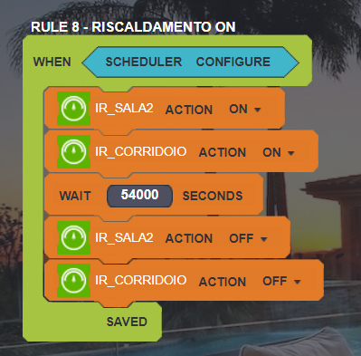

I have a rule.
if I set wait 120 sec it works, if I set wait 54000 it doesn't.
Is there a time limit?
and in this case, how could I modify the rule in order to have it working?

Styrange but after 2 days now the rule works.
Solved alone.
Thankyou
It probably needed to synchronize.
Hello Gianit. I have also experienced issues with wait blocks in the past and sometimes it seemed like they were running in triple speed when doing a syncronization or just after.
So since two years back I never use a wait block longer than a 1 min.
