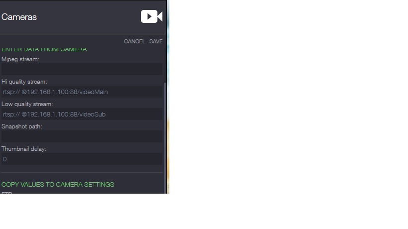

Scaned for camera in ziapto add device, (cant find it)
Put in the Ip manually. and added the port 88
Added username and password for my camera (in the camera settings)
Foscam states in their manual that you should use one of the following:
1) rtsp://admin:123@192.168.1.11:88/videoMain
2) rtsp:// @192.168.1.11:88/videoMain (i have used this since ive added the username in the box ?
3) rtsp://:123@192.168.1.11:88/videoMain
4) rtsp://admin@192.168.1.11:88/videoMain
I also tried to add camera without setting port in the add camera box.
Still the same.

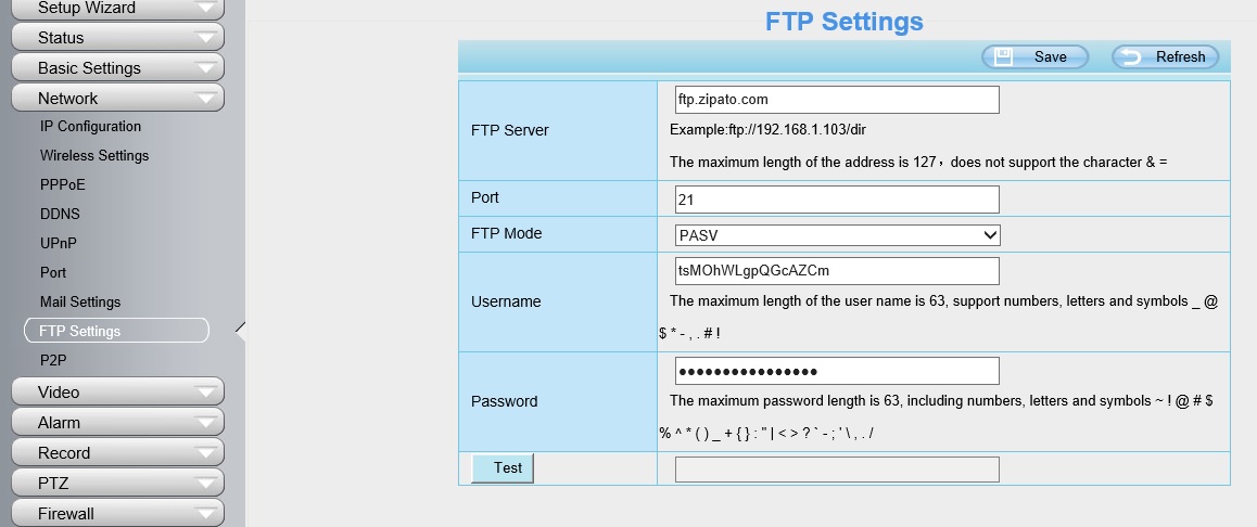

I also have problems using the zipato ftp server on the foscam,
When i copy paste the information:
Adress, Username, Password
(there is no box to add directory in the foscam app)
See: foscam ftp

Forgot to mention that i tryed this on vlc and it worked i got the stream:

for snapshot use this. change to your ip nr = xxxxxxx
usr = username for your camera pwd=password for your camera
http://xxxxxxxx:88/cgi-bin/CGIProxy.fcgi?cmd=snapPicture2&usr=xxxxxx&pwd=xxxxx
Hi quality stream :
rtsp://@xxxxxxxx:88//videoMain
But unfortunately this camera cant use zipato ftp server. This camera creates a new folder when it upload picture and zipato ftp server dont allow creations of folder.
Ok i wil test it to see. hope it works.
But even if it wont save the file will i be able to send snapshot in email?
No. you cant send snapshot in email, because of zipato ftp server will not receive any picture from the camera.
Because of the folder creation.
So, the inference here is that Foscam cameras aren't compatible with the Zipato system?
Yes, thats right.
Ok i have tested the path you said, it stil wont stream, i will try a little bit more and maybe open a ticket.
