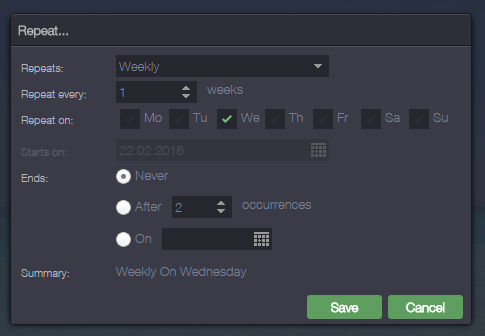

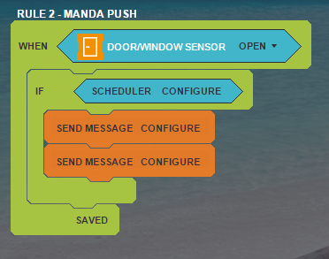

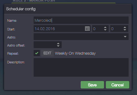

D'd like to be notified (with email and push) when the door open but only if wednesday.
I dont need the notification on other days,
I tried with the attached rule, but doesnt work.

you cannot use scheduler this way
your rule should look like:
if door open
join
if day of week is wednesday
do action

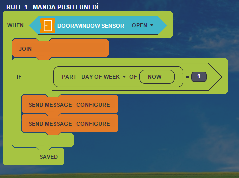

Is the attached screenshot the right way?
1 is monday or sunday?
thank you
Files: push.png
looks good, but day of week you have to check. Here is 1 normally Monday. In some timezones it is Sunday.
