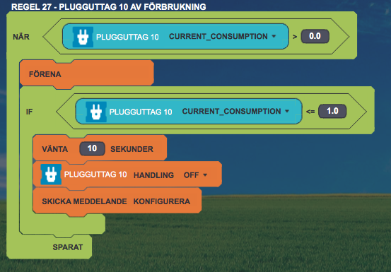

hello, why does my rule only work if there is NOT loading. But when I put something (loading) in the fibaro plug then the rule does not work, what is wrong? please help.
I will try to explain how the rule will work:
When I press the button on the fibaro wall plug, and if there is "loading", then if "loading" drops below 1watt, then it should start count 10s.
If it still are below 1watt, the fibaro plug shall go OFF.
If there is NO loading from the beginning when I press the button, it shall go off after 10s
Replies (4)
is there someone how can help me?

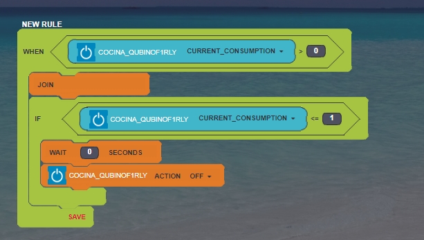

Hi Dennis, would you mind explaining again? Not sure I understand what you want.
Hello Dennis,
I'm also not sure of what you want to achieve. This is what I understand; when the Fibaro Plug detects a load (electric power consumption), if the load is less than 1 watt the plug should go OFF after 10 seconds. Is that correct?
Hello. Sorry about My bad english and explanation.
I think you have right alberto.
The rule is to load My iPhone, so when i press the button on fibaro wall plug, It should load My phone and when its done, the plug will go off
No need to apologize. Try something like the attached, change the wait for whatever seconds you want, I used a Qubino Flush relay to demonstrate, dont have Fibaro wall plugs.

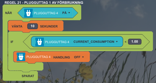

Hello again. My rule does't work anymore, is there someone who can help me?
