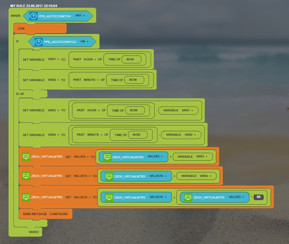

Indeed this is a good one, specially because there is no way using the puzzles to separate integers from decimals. However after thinking for a while I came up with this solution, I made a test, will let you know how it worked.

I was trying something similar to Alberto's. But I have an error and not able to find it... Anyhow, Alberto, you have to take in account what happens if device was switch ON one day and OFF next day to do properly the operations.
Regarding the virtual meters, I don't understand why you use them instead of variables. Could you explain Alberto? Thanks!

I also thought about doing it like Klaus, the only issue I see is the fact that if your controller reboots you will miss that time. Accuracy I think you will get very similar from both solutions, both resolutions are minutely. Klaus' solution doesn't care about which day you started and finished counting, that is a plus.
Yes indeed, that is a problem I was thinking about it but cannot find a way to solve it that I like, I will keep thinking about it.

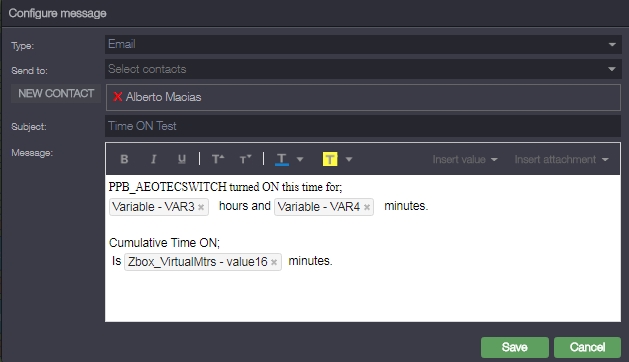

Variables reside in the controller and their values get wipped out when you reboot or power off the controller, virtual devices are created in the controller but they are connected to Zipato Server, so, in the event of a reboot, Zipato controller will read values from the server, so technically you won't loose data (unless you experience an internet outage while storing data to virtual meters). If this is important to you I would use virtual meters instead of VAR1 and VAR2 that way if your controller reboots you still would get good calculations, I didn't do it because those are the only placeholders (value5 and value 16) available from the virtual meter I use for these purposes and didn't feel like creating another one.
