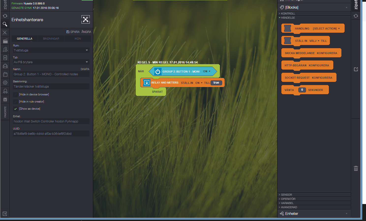

Hi I'am a new to this and need some help.
This is the case:
I can controll the Qubino relay with smartphone, but I wan't to do a rule for the Nodon Wall switch.
I have done simple rule with When=Wall switch button 1 on.
Put Relay and meters to ON True
See attach file
Any idea what I'am doing wrong?
Hans
Hello
Try it with the Action Block
Hello

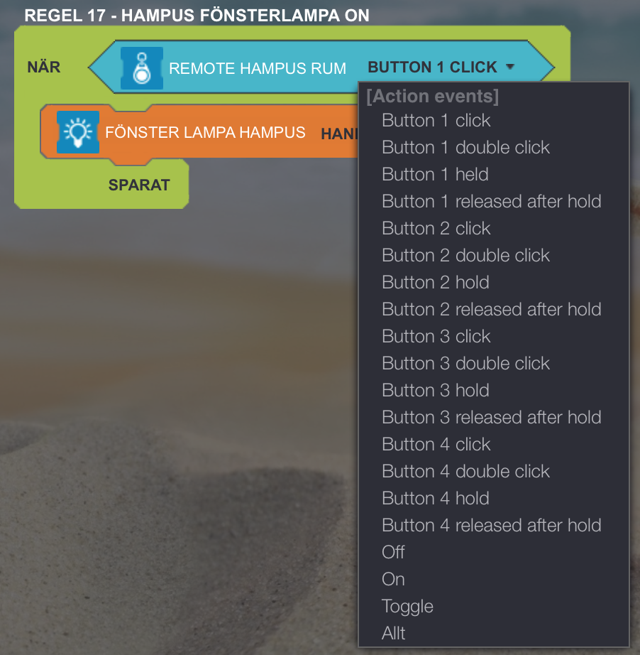

Hello, Don't use the "Group 2: Button one" There is also a Nod on Remote added use that one and the actions it provide.
But if someone has a rule with working Dimming using the actions "hold" and "released after hold" i would like to se that. Cause i don't get the "released after hold" to work.
Thx! Jocke. Worked like a charm.
