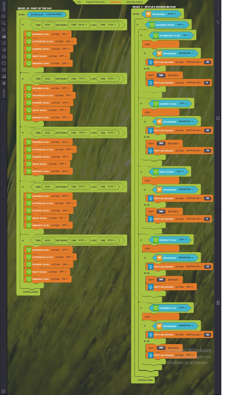

good idea we have to share more rules. Zipato should make a tipic for it ...
I have a different approach:
