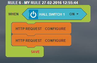

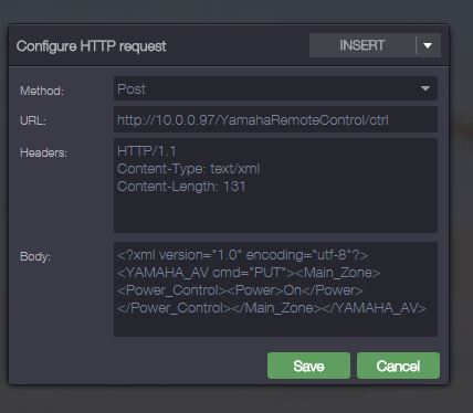

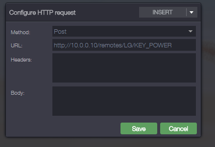

Im working on scene control for the home theater with a combination of a Raspberry Pi running Lirc_web (TV) and the native network function on a Yamaha RX-V675 Receiver. I have both systems working on my local network (10.0.0.xx) through Postman on a laptop using simple Post requests (http;//10.0.0.xx/remotes/LG/KEY_POWER) to the Lirc_web and Yamaha specific command set to the RX-V675.
All systems including the Zipato are on the 10.0.0.xx network and at this stage using a simple trigger, when SW is ON, send HTTP Request.
At this stage I cant get the Zipato to trigger the requests, anyone have any ideas?
think the LG TV request you used a ; instead of : after http
Well spotted, Adrian ;)
