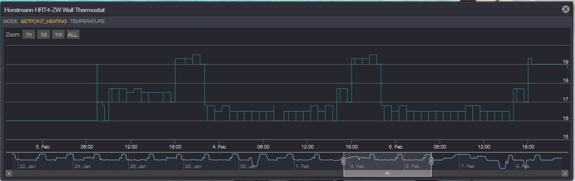

I add the following problems:

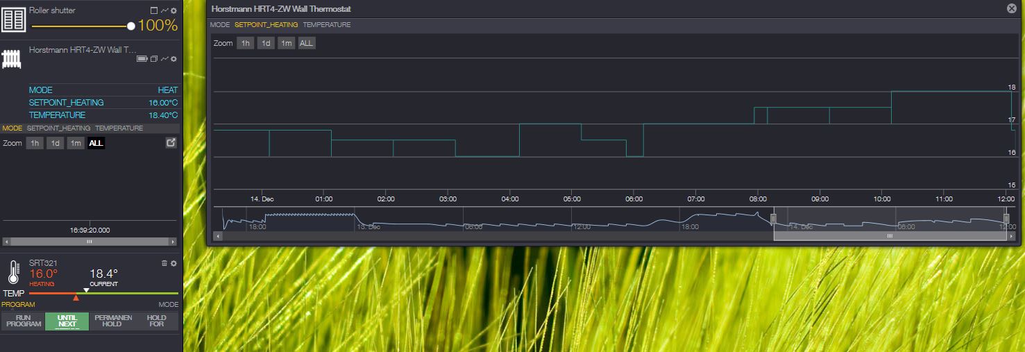

1- when program is running, it switch to "until next period" at SRT321's wakeup time.And setpoint_heating t° increase by itself to the next entire value.
For examp: 18.6°program => 19.0°when switching to next period. But t° in SRT321 chart shown 19.3°; then 19.5°.
Other sample: this morning the setpoint _heating t° was 16°. SRT321 increases by itself to 17° or 18° (see attached file SRT321_Problem2.jpg).

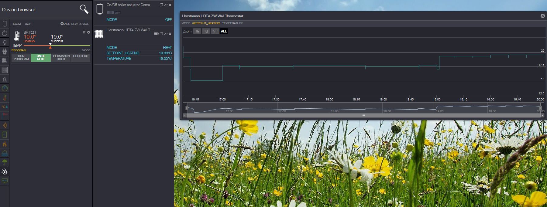

Firmware 0.9.999.8q

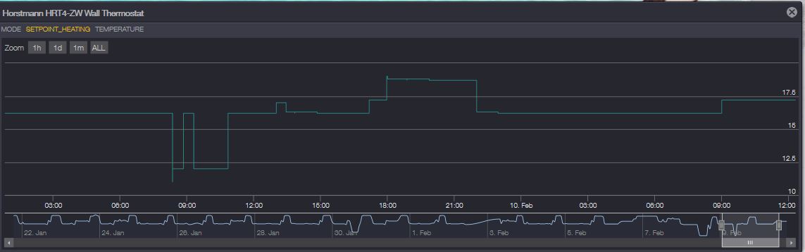

When the Heating program is running, it swifts itself between Mode "Offf" and Program "Heating" permanently.
Comments above are still on actuality.
The setpoint_heating chart is smoothed now (see attached files).
