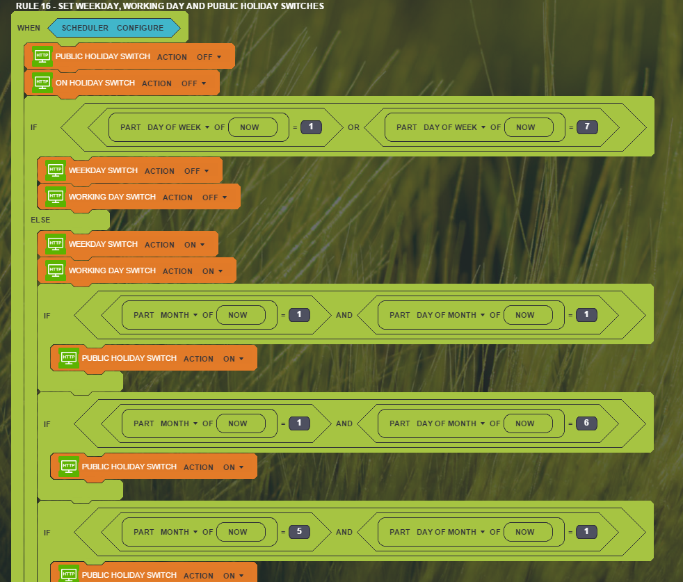

@David: here's what I've done for weekdays and holidays.
As Andreas said, I use a virtual switch for weekdays/weekends. First add a device, choose virtual device, and then virtual switch. Call it "Weekday switch" or "Weekend switch", depending on which way around you want to do it. It's just a boolean on/off variable, basically.
Then set up a rule that runs, say, at midnight every day (I put 1 minute past midnight just in case the box takes a while to update some of its values). It tests the day of the week and sets the weekend/weekday switch accordingly. What I also do is set a "working day" switch which defaults to true on weekdays. I then have the rule check all the public holiday dates and set a "public holiday" switch. At the end, if "public holiday" is true, I set "working day" to false.
I tried HeroS's approach with IFTTT and Google Calendar, but Google Calendar, astonishingly, lacks any notion of categories. So even if you import public holiday dates from a shared calendar, there's nothing to distinguish a public holiday from a dentist's appointment (unless I'm missing something). One way to solve it is to add a keyword like "publicholiday" to the description and use that as the trigger, but since I don't use Google Calendar it sounds like more trouble than it's worth. Sort of negates the benefits of having someone else configure the dates for you. The other big problem with IFTTT/Google Calendar is that you can't trigger something when an event ends.
Instead I've just set the dates manually in one big monster rule. Most dates don't change from year to year and you know they're going to be non-working days even if they fall on a weekend. The few dates that differ from year to year I'll program in by hand once a year. I'll use the same rule to program my vacation dates.
I've attached a snapshot of part of my rule.
