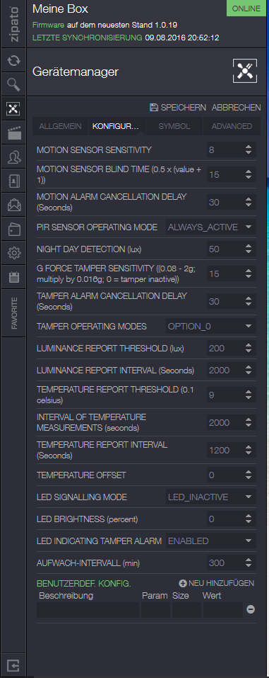

I think (or better hope) the battery consumption is affected by your settings. I use my fibaro sensor for nearly two month now and the battery still shows 100%. But I have to admit that I deactivated all those fancy lights and set up the intervall for temperature and luminance. (in my opinion luminance can´t be trusted anyway. I mainly get values between zero and 5 in a corridor which is never dark due to outside lights)

Klaus,
How do you update the device with the new configuration parameters?
I´ve changed the sensor LED to inactive, synchronized the zipabox, but no change in the motion detector.
It still have the LED turn on on motion.
I´ve also tried to configuration of the node on the advanced tab. No luck.
Did you force a sync between the sensor and the ZipaBox? Otherwise you will have to wait for the wakeup-time to get the new settings in the sensor. (BTW, this is a common problem with battery operated devices.)

Hi Anders,
as some others mentioned before: The problem is, that the sensor doesn´t listen all the time. You have to awake the sensor by pressing the button. I too don´t remember the correct procedure but I think I pressed the butten three times, before I started the sync process. I´m still confused because I would have expected the sensor to take the new setting at least during the next wake up, but now I think, that you need to manually wake up the device to get the setting written into the sensor. Wake up time is 300 min in my case but to switch off the led I had to awake the sensor manually before sync.

I´ve changed the config in the zipato config tab, and just waited out the awake time over night.
The next day the sensor had changed the settings.
On the next sensor i´ll buy ill try to force the settings into it.
Anders,
To manually "wake up" fibaro motion sensors you need to quickly press the B-button (inside the sensor) three times.
