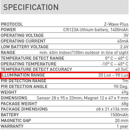

How exactly does the multisensor Quad meassure light? The attribute state returns values in percentage. Percentage of what? I can imagine 0% means complete darknes, but what is eg. 60% or 98%. And what is the minimum and maximum Lux values it can meassure?
You are correct 0% is darkest, 100% is brightest. Manual shows minimum at 20 lux and maximum 90 lux, see attached.
Thank you Alberto. Sorry I oversaw this information in the manual. This means that the quad sensor is only meant for indoor light measurement as 90 lux equals less than a "Very dark overcast day" according til Wikipedia.
