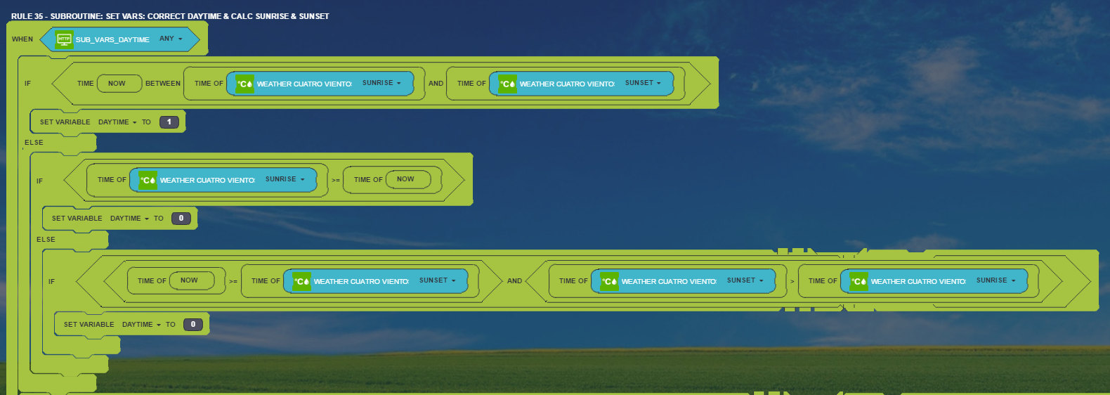

This is my rule. I also have the standard rules that run at sunrise and sunset, but this rule runs every ten minutes and corrects the state in case it gets lost due to a restart or whatever. There is more to it, but it's detail that's not important here. The last check is a "sanity test" which is probably not necessary - just in case the Zipabox sunset/sunrise data is screwed up or not set and is has the value of 0.

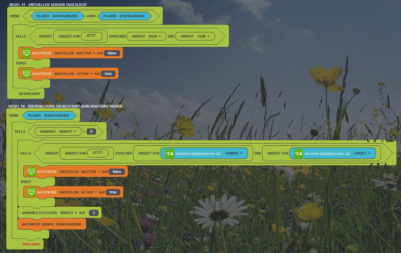

Doesn´t that put a lot of workload on the box? I prefer virtual switches (they keep their status) and set them twice a day and after a reboot. Haven´t had any problems with that so far (First rule is triggered twice a day (sunset/sunrise) and sets the virtual switch or sensor to day or night and the second rule does the same after a reboot. Until now it worked fine for me.

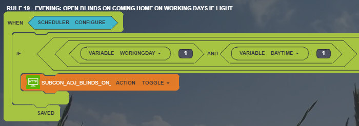

@David: Very interesting solution although I only understand it partly. In addition I can only see a part of the rule. How do you use the variable "daytime" in your rules?

I just test for daytime = 0 or daytime = 1. See screenshot.
The rest of the rule just calculates minutes since sunset, minutes since sunrise, minutes until sunset & minutes until sunrise. I use these in other rules.
