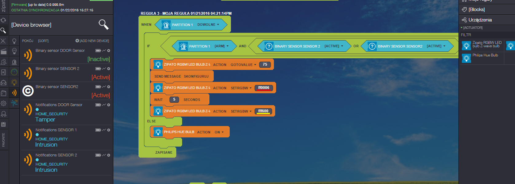

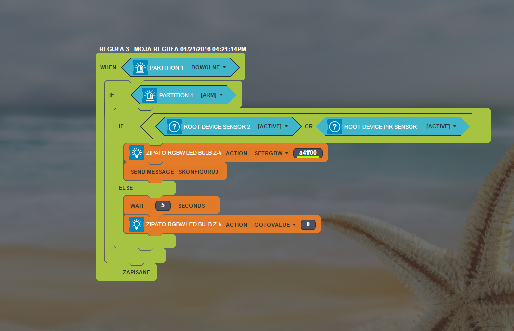

My rule does not work properly to arm the alarm. Any suggestion?
Files: arm.png
Replies (1)
Hello Krzysztof,
root device sensors you are using in this Rule are currently not supported so they might not work perfectly in Rules creator. Also in the IF part of the Rule action setrgbw will only set the color but it will not turn it On so you need a puzzle action go to value to turn the lamp On. Of course don't forget to Synchronize rules after you save a change.

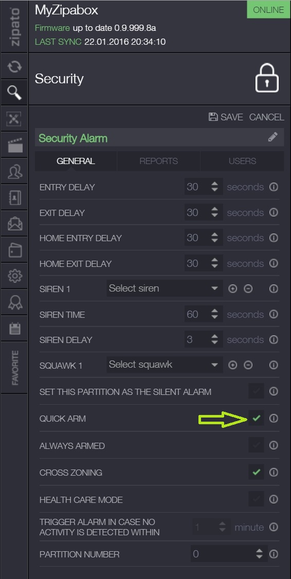

Do you have the quickarm option on?

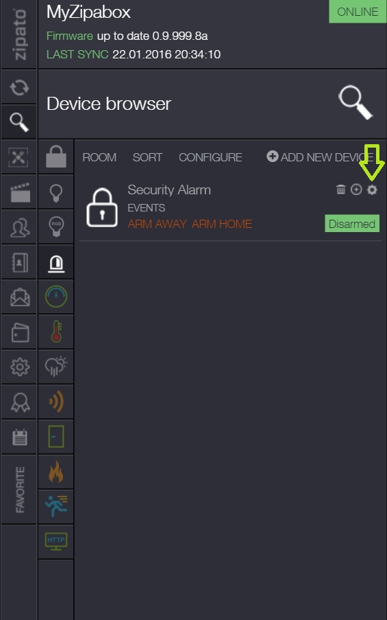

OK I deleted that sensors and added them again and I changed rules now. But doesn't working. Where can I find quickarm option ? I have no idea whether on..
Krzysztof,
See attached.

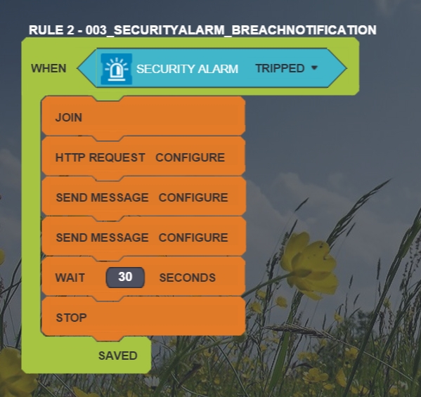

Try starting simple, add one perimeter sensor. Make sure you set the alarm to send notifications to at least one contact, or create a rule like attached. Arm the system and trip the sensor, if you configure the sensor (zone) as perimeter any arm (home or away) will trip the alarm system, if you configure the zone as interior the system will only be tripped if its arm away. Make sure your entry/exit delays are not too long and the rule that arm the system its arming the alarm succesfully.
