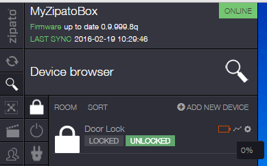

I've the same problem with my "Danalock" dorr lock. Two weeks after I got the lock and joined it on the Z-wave network, the batteries were almost empty! On the same day, the battery level change from 100% to 70% - 52% - 48% - 21%, then they hold for 2 more days and then they died! I can still contact the lock, but it doesn't have the power to move the deadbolt.

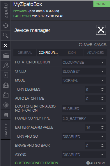

On the template Zipato uses for the lock, there is no option to set the Weakup intervall, but it seems Danalock doesn't provide access to that paremeter even if you wantto change that manually (using the parameter Id).

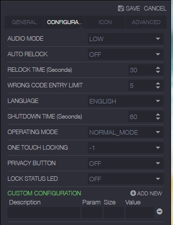

It appears to me that my batteries are not draining like you guys, I use Yale Door Looks, but seems there is no configuration parameter for wake up interval either. Also the documentation provided in manuals from Yale is very poor regarding Z-wave, I even tried to contact the manufacturer but I got a negative answer saying that since I wasn't a z-wave product/controller developer they couldn't provide any more information. How do I know if my inclusion process was succesfull or I need to re include the device if I dont know which parameters I should have in my interface???
