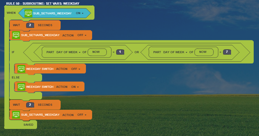

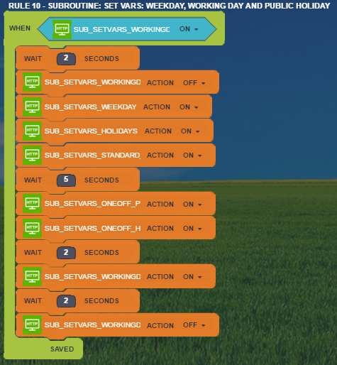

In my example, the invoking rule (rule 10), which is itself a subroutine, invokes many subroutines, including rule 50, which simply sets up the "weekday" switch.

It's worth noting that, if you run several subroutines in succession, the Zipabox won't wait for the first to finish before triggering the second. It's just flipping switch states. So you might to chain together subroutines that depend on each other, or insert wait times, whatever works best.

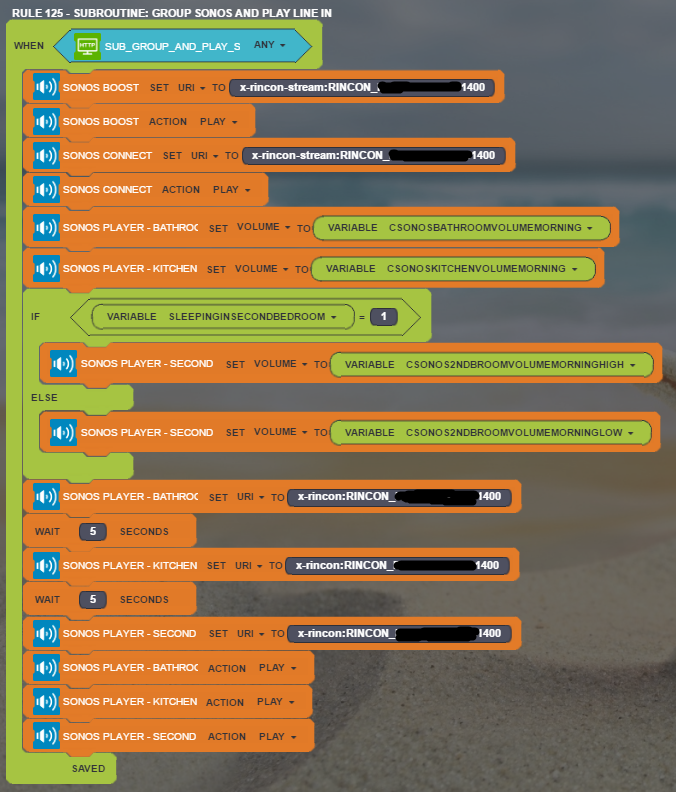

This is a great way to save duplicating the same code in multiple rules. I read another post where you created a subroutine to play announcements on several Sonos players you have scattered around your house. I'm planning a similar setup for my house. Thanks for sharing!

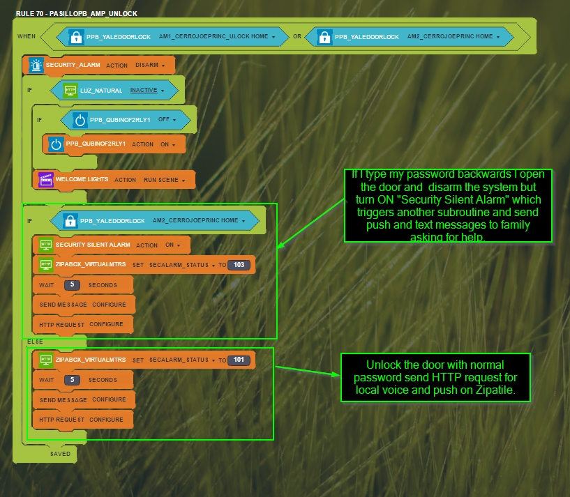

That is something I never though of sharing, I guess it would be useful for many. I use the same approach for subroutines I like to trigger automatically and manually, also I have combined scenes that trigger a few switches that trigger rules (subroutines).

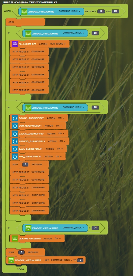

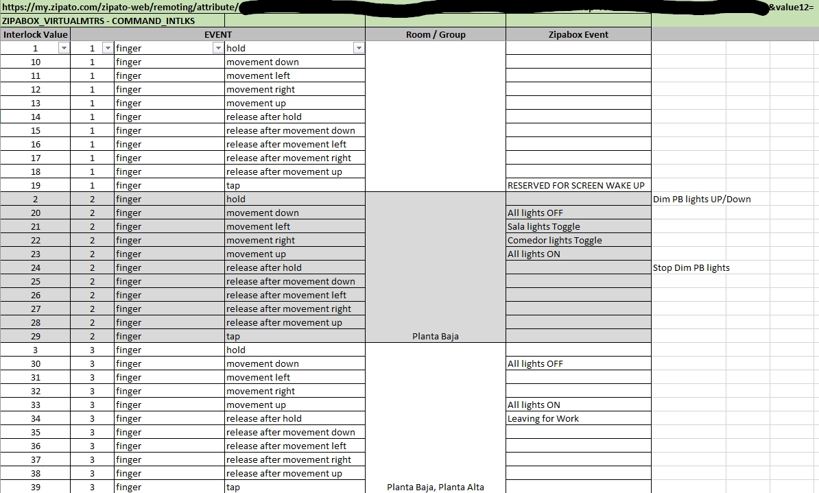

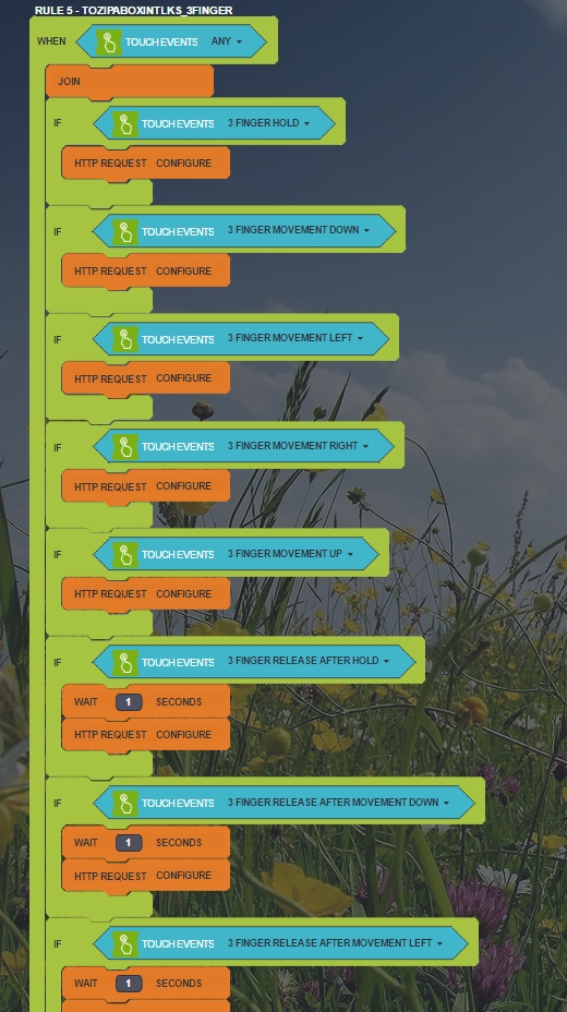

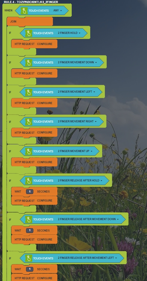

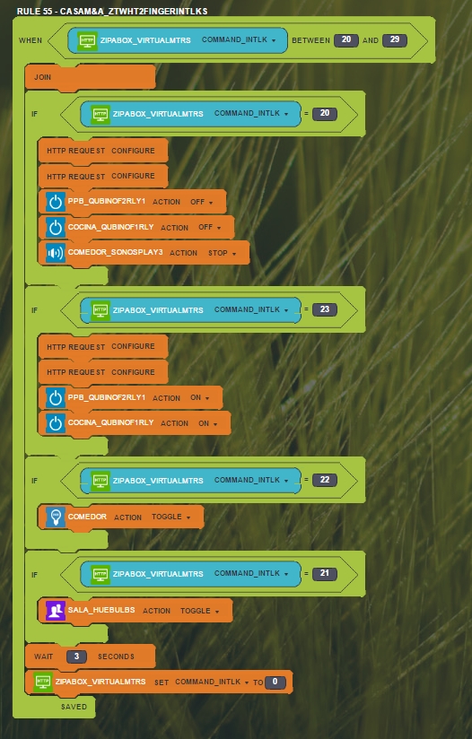

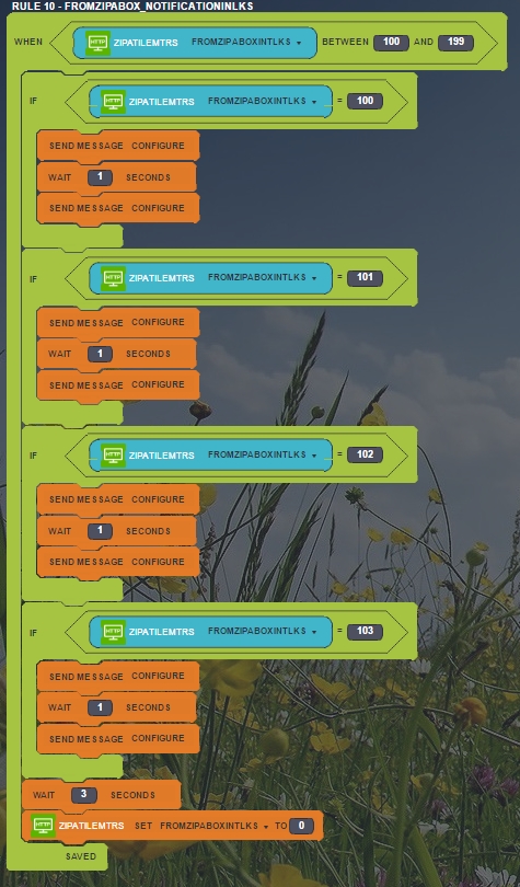

Another approach I use for Sonos and Local voice on Zipatile is using virtual meters and different values, for example 1 to 100, that way with one meter you can trigger many different rules or subroutines. This last method can even be used to interlock Zipatile and Zipabox without a cluster, you just setup a meter on both and change their values using HTTP POST requests.
From my Zipatile I sent touch events to zipabox and from zipabox I send local voice and local push messages to Zipatile.

Alberto, could you elaborate on what you do with the virtual meters, or post an example?
