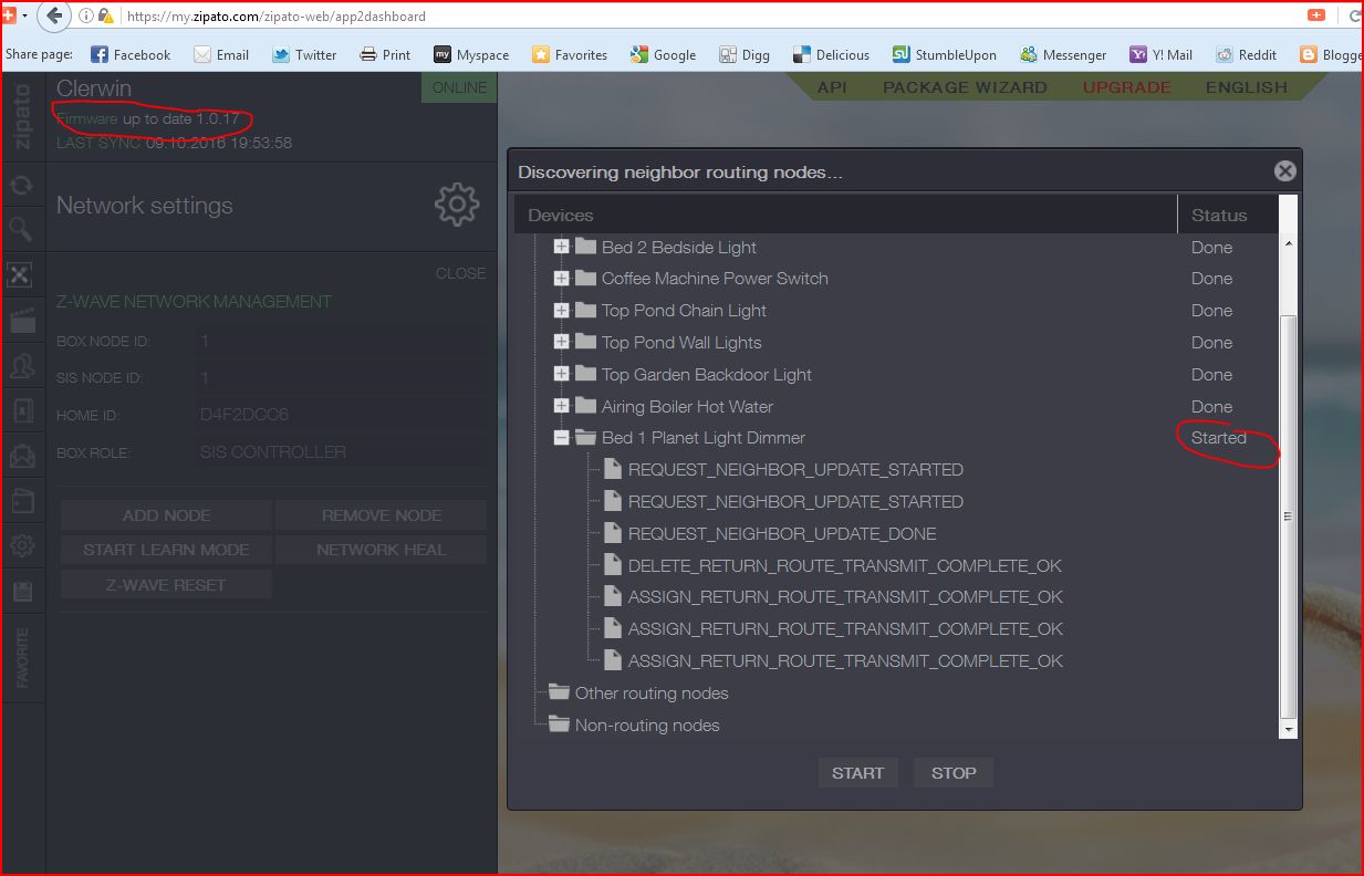

Many thanks for your help. I have tried the Network Heal many times since you suggested it and it never seems to actually complete (as shown in the attached screenshot). It sometimes does nothing before "hanging", other times it does a lot more but never processes every device. Am I doing something wrong?

I have noticed that sometimes indeed the network heal is slower than others, usually when I have tried to do it several times. What I have done and worked for me was to synchronize the controller, reboot and then try again. Also one or two times I have had the process hanging up in the same spot where your picture, where a routing node started the update and you can see the assign network route complete message. I gave it a few minutes and it kept going.
Now, remember battery powered devices need to be manually awaken, process that varies depending the manufacturer but usually is three clicks on their "join network" button. These devices wake up on very long time intervals to save up battery, usually once or twice a day, so when you get to this point get ready to manually wake devices up.
