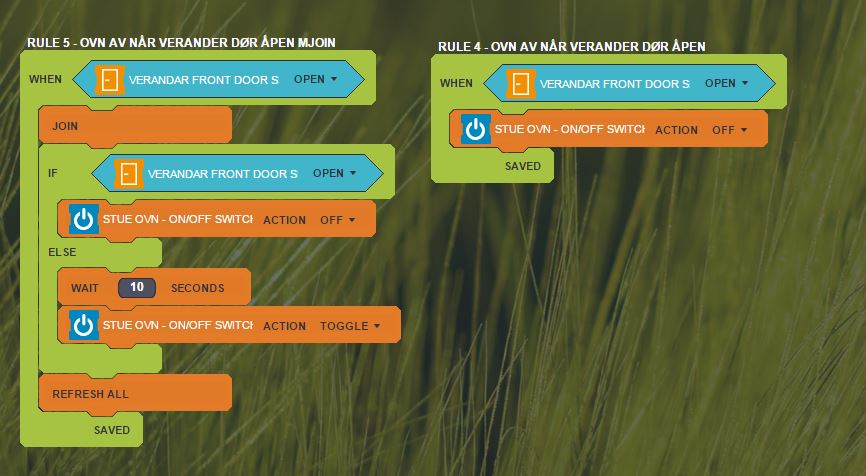

I have 2 electrical heaters controlled by a virtual thermostat in zipato.
When i open my veranda door, I want one of my heater to go OFF.
I tried to make a simple logic with IF logic: IF door open, heater "living room" go off.
Its off in about 10 min, and then the heater goes ON even if the door is open.
I have made som logic with "join" logic , but no of them will work, see attachment.
What im doing worng ? I want: When door is open, heater in living room should be off until i close the door.
The two rules in Attachment is just example of what i have tried. One at time.
