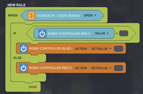

I have problem in writing rule for following purpose:
for example when i open the door , if rgbw bulb is blue it becomes red.
I dont know how to have feedback from the color of RGBW in Rules.
Thanks,
Maybe you could do something like attached screenshot
Do not know values directly, but it could be a start
Thanks a lot it solved my problem.
