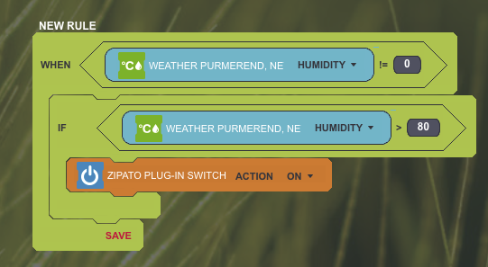

How i can make rule that puts wall plug ON when virtual weather station humidity rise example over 80 ??
You can do that by using the meter as shown in the screenshot
