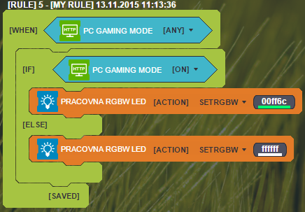

1. I have a rule, where if I switch the virtual switch on, the RGBW bulb changes it's colour to green. If I switch off, it goes back to white.
Now, how to make the colour to be a random and not fixed green?

Files: rule.png

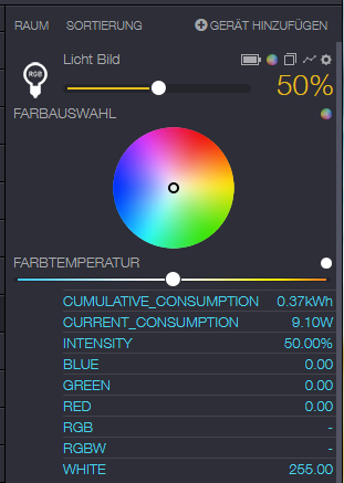

Is that a Fibaro RGBW Modul? If yes it's look wrong. In my case it looks so:
/408b12efdf77a9b519c6eba91548a505
