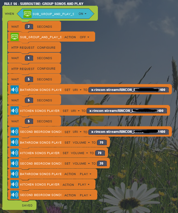

I'm posted my two rules:

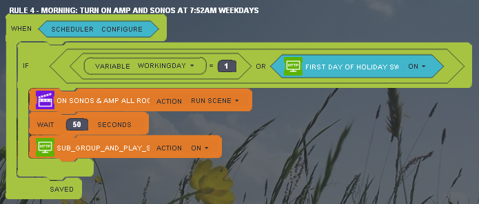

1. One rule turns on the Sonos components via the Z-Wave sockets, waits a bit, and then invokes the "subroutine" that does all the rest.
2. The subroutine is invoked via a switch. The first thing it does is turn the switch off (otherwise it can never again be invoked). It must first wait 2 seconds, because otherwise the 2 changes to the switch state happening in rapid succession won't work. It then sends the HTTP request to connect the Sonos Connect to the line-in source, and another to start it playing. Each Play:1 is then set to take the Sonos Connect as the source, their volume is set and they're set to play. The Plays need to be sent the RINCON address, which is the MAC address of the Sonos Connect. You can find this out by going to this URL:

currently: PAUSED_PLAYBACK x-rincon-stream:RINCON_xxxxxxxxxx01400
That last bit is the MAC address you need (all have 01400 added to the end. You must also include that.)

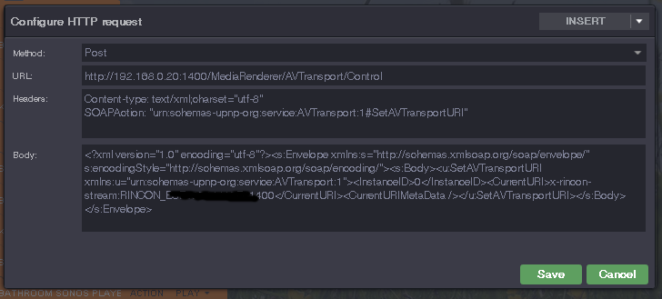

3. The HTTP Post to set the Connect to line-in sends as the URI the MAC of the Sonos Connect itself! At least that's what I'm doing right now. It seems to work. So it's the same number as above.

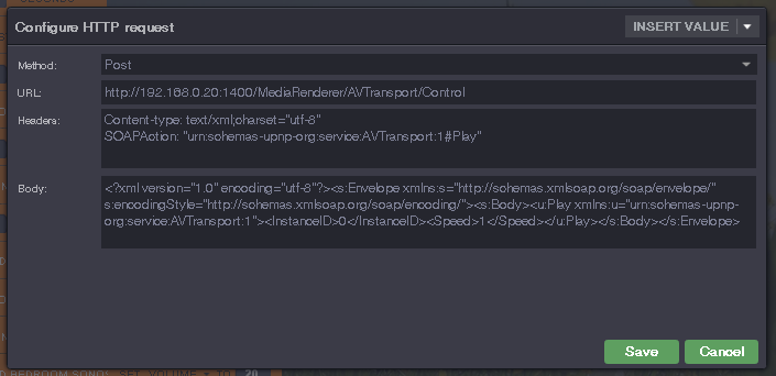

4. The HTTP post to play the Connect is simpler, not much to say here. I stole it all from web sites hither and thither.
Be careful with the syntax of the HTTP POST body. It's sensitive to things like whether the quotes are double or single (they should be double).

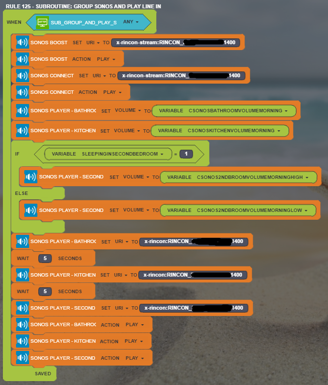

I figured out how to group speakers. It's actually super easy. Instead of x-rincon-stream:, you use x-rincon: for the speakers (pointing them to the controller, Sonos Connect in my case). If you don't have the Connect, I imagine you would pick one speaker and point the rest to that one.
Just tried it, and it works.

First take a look at what I posted above. Here is the new version of the rule. I've removed the HTTP requests, added some constants in place of the hardwired volume numbers and altered the Play:1 URIs from x-rincon-stream to x-rincon, played with the order a bit, and altered the switch that triggers the subroutine so that it works with "any" rather than just when the switch goes on (much easier). Also I've added a Boost to my system so I've included that too.
The Connect and all the plays are sent the MAC address of the Sonos Connect. x-rincon-stream tells the Connect to take the input from line in. x-rincon tells the Plays to group with the unit whose MAC address they are being sent (the Connect).
Connect:
x-rincon-stream:RINCON_<MAC-Address-of-Sonos-Connect>01400
Play 1s:
x-rincon:RINCON_<MAC-Address-of-Sonos-Connect>01400
If you had just three standalone Play:1s, I would imagine that you'd choose one Play:1 to be the source and set that to whatever sound source you need. You'd need to do some investigating to find out exactly what URI you need. Then the other two Play:1s would be sent a URI with the MAC address of the Play:1 acting as the sound source, plus x-rincon, meaning they group with that speaker:
x-rincon:RINCON_<MAC-Address-of-coordinating-speaker>01400
