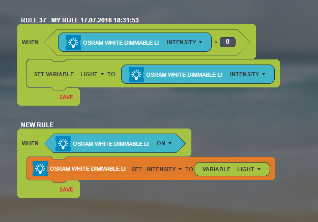

I am just getting started with the rules creator and I can't seem to find a way to simply turn a dimmer on (to whatever its default or last value was). For example, if I manually dim the lights at the switch I don't want my motion light rule to "gotovalue 100", I just want the lights to turn on to whatever their last dimming level was.

1) Is there a simple on/off action for dimmers to just "turn on" to whatever previous value was?
2) Is there a way to set value of a dimmer from a variable or other device?

Try the attached rules and let me know how you go?
I am using Leviton Vizia RF+ dimmers.
The rules you attached work perfectly! Thanks for your help.
