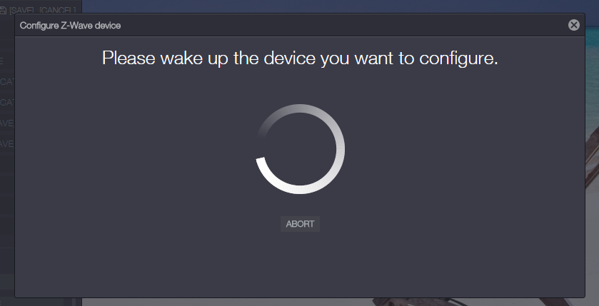

Open the setting and go to andanced tab (not the config tab). it is the 4th tab for the main device. In there you have configure node. Click on it and confirm. It iwll then ask you to wake up the device (probably when you press a button on the remote and they should communicate to eachother.

My experience so far:you connect to power the replacement device and then you start the procedure. It is like including the device will ask to wake up. It was straight forward for me.

For me the failed one was like offline and the replacement simply powered. Ot will start inclusion process when clicking on replace node. Neved delete the failed node as there will be nothing to replace...
