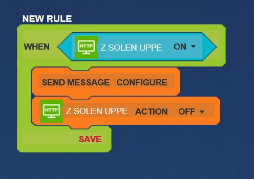

This one trigs every time that "Z Solen uppe" goes "ON".

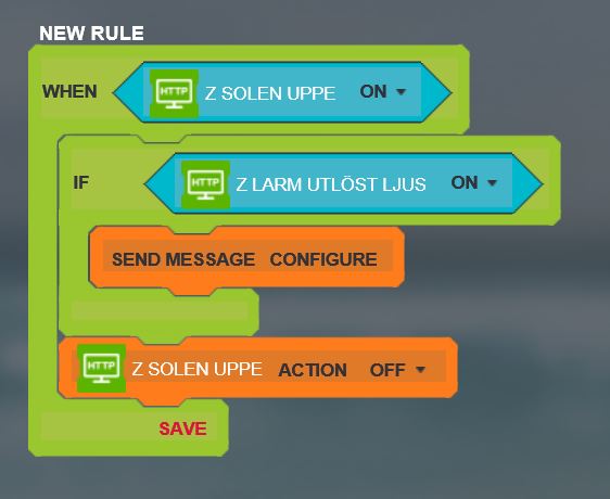

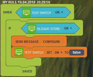

But that I want to do is to allow or avoid the action of the rule (here send a message) with the status of "Bloque Store" Switch. The Rule is triggered by "Test Switch", if "Bloque Store" is ON do something, if "Bloque Store" is OFF do nothing.
May be there is another solution to do that.

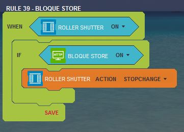

My goal is to prevent a roller shutter controled by a Fibaro module and a electrical switch to move even if the the roller shutter receive the order to move from the electrical switch (in fact neutralize the electrical switch).

Alain, are you perhaps experiencing the virtual switch state synch problem that happens after reboots or disconnects?
What are you seeing? Does the message never get sent? Or always get sent?
I dont know for the rule synch, but it's very long...
The message is never sent.
Actually I did exactly what henryfredrikson suggested, without success.
I tried using the http switch as Actuator (Attribut Events=On) or as Control (Attribut Events=On or Action Events)

Try a couple of things:
1) Toggle your Bloque Store switch twice, to make sure that it's really on. Sometimes what happens is that we are seeing a switch as "on" in the cloud, but because of a disconnect or reboot it's actually off in the Zipabox's memory. (off, or in a "null" state). Toggling the switch twice will resynch it and ensure it's on. Then run your test rule and see if it works. If it does, this is your problem.
2) Try using a variable instead of a virtual switch, if you can. See if that works.
If 1) is confirmed, then you might find that 2) works more reliably. Also look up "reboot detector" to see what Henry and I have done to get around the state synch problem.
