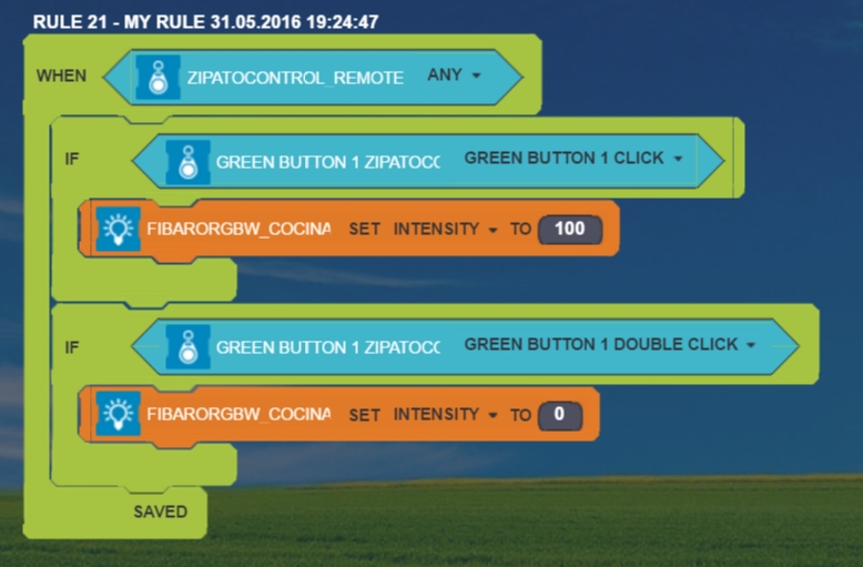

I got a Zipato Remote a few weeks ago, I didn't have time to play with it before and unfortunately my first attempts weren't succesfull. Looks like when you add the remote 8 control and 1 sensor devices are available to pick from the rule creator.
I created rules trying with all my lights without success, using "click" and "double click" without luck. First tried directly on WHEN block, then tried the attached approach (first trap with WHEN "any" and then IF). Hope someone knows the trick for this.

Try to "refresh all" before first if clause.

I had exactly the same problem with a cheap 433MHz remote. It doesn´t seem to work with only one rule. It sometimes worked, sometimes not.
I saved two rules instead (Rule 1: When click 1- Intensity 100, Rule 2 When doubleclick - Intensity 0)
That did the job. But I´m going to try the refresh tip as well.

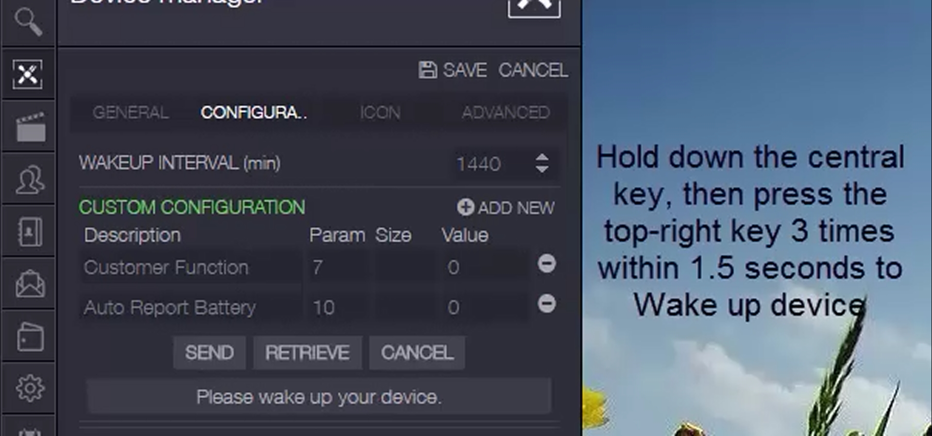

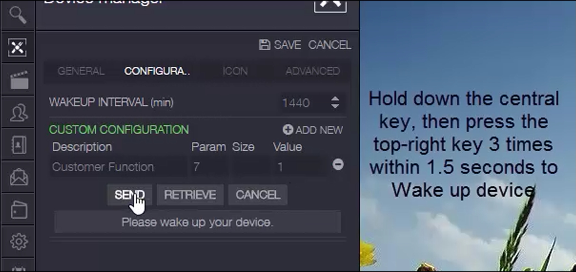

I just want to share the fix with all the community, thanks to Pero and Mato for helping.
1. Remove device from network.
2. Reset device to factory settings. See procedure above or in the remote's manual.
3. Re-Add device to network.
4. Go to device settings and add custom parameter "Customer Function" as shown in the attached images.
5. Add custom parameter "Auto Battery Reports" as shown in the attached images.
6. Make sure you wake up the device so it takes configuration from the controller.
7. Add your rules again and test.
