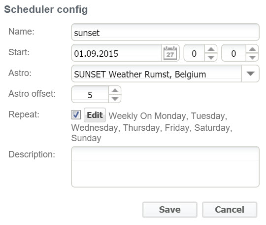

Well -
for me is doesn't work... I have already opened a ticket but no luck so far. My
rules have been working for the last 1,5 years so that can't be the problem. I
have now updated all my rules with a new date and will evaluate tonight
(sunset).
Well -
(sunset).

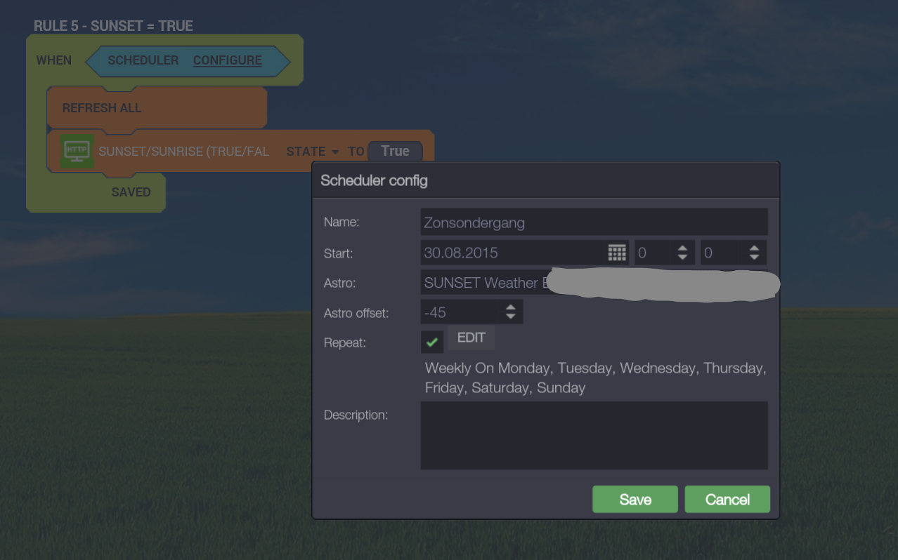

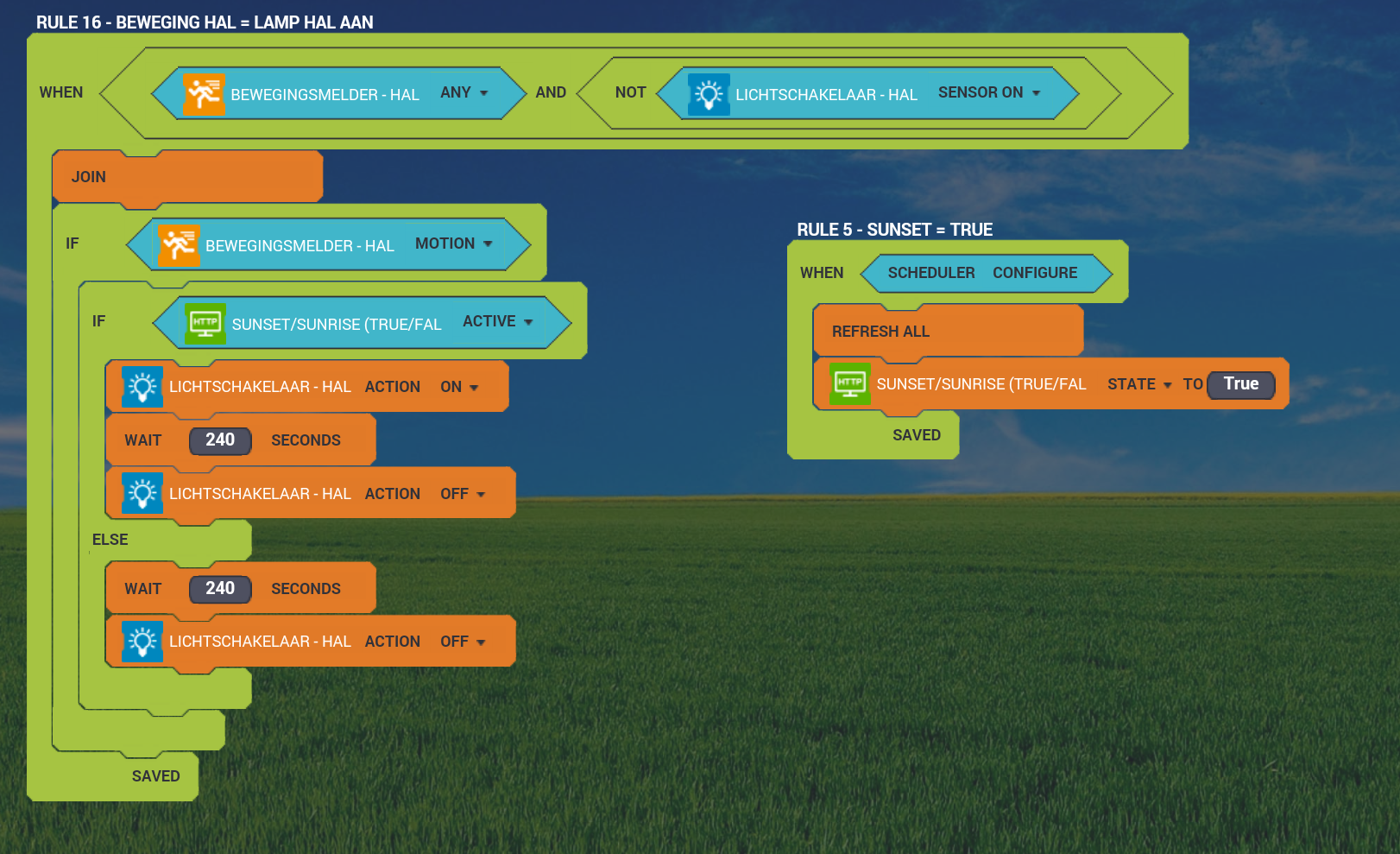

Sunset rule was not changed before this problem started
See rules attached.
The sunset true rules itself is not working and therefore the rules related to this sunset neither.
See rules attached.
