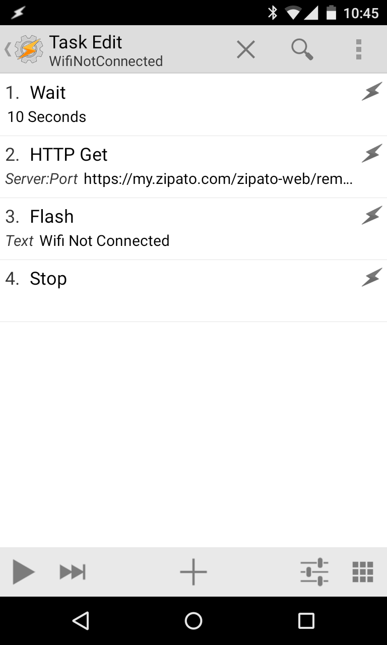

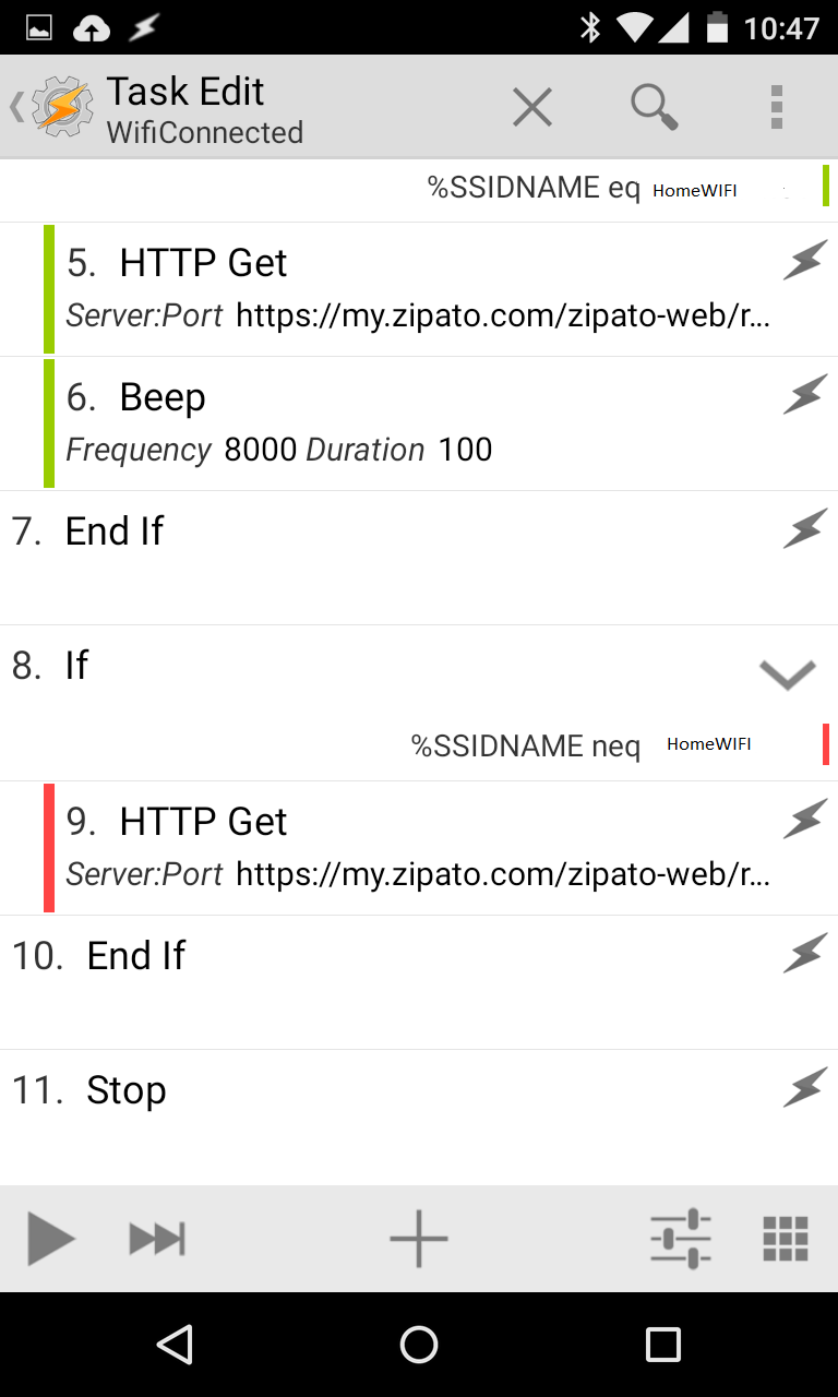

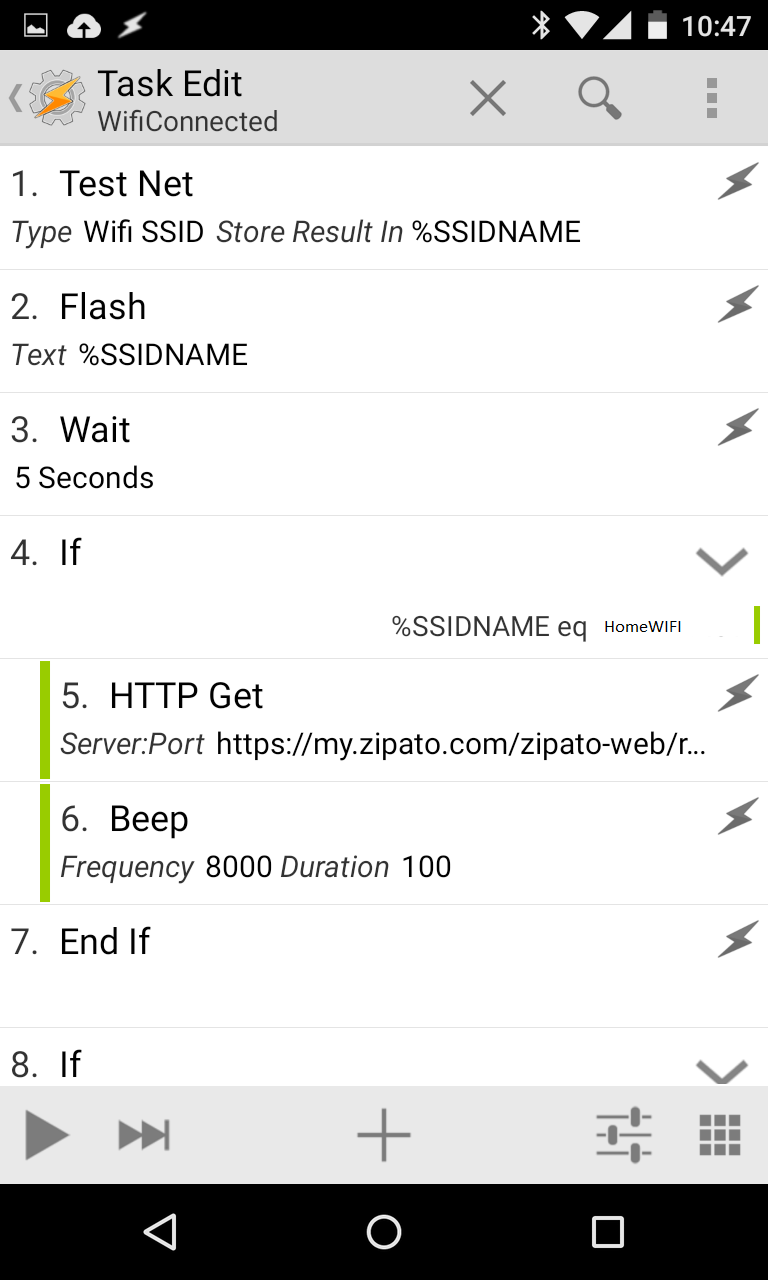

I use two tasker scripts, one to set the sensor to "0" when Wifi is disconnected (I have mobile data enabled). The other to run when a wifi connection is established. The sensor is set to "1" if connected to my homewifi and "0" if connected to another wifi.
