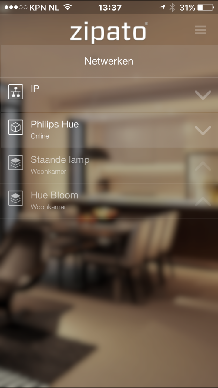

Hello Thanks Milan for the feedback In the meantime I've upgraded to the P version delete my old hue device and include again and is working :)

After i installed all hue updates with the hue-app i managed to add my hue bridge.
