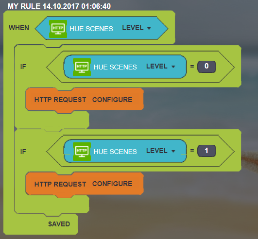

I have bought hue and suffering from same issue having to trigger the 'On' scene twice.
I have found a workaround, using a virtual level control and a rule that reacts to the different values by sending various http requests thanks to Alberto's tips above. I then can setup a scene with each meter value: running the scene will then fire the appropriate http request.
For instance, I have a level control called 'Hue Scenes' and create a rule that
if meter is 0, it sends http://192.168.1.x/api/userkey/groups/2/action with a body of {"on":false} to turn lights off
if meter is 1, it sends http://192.168.1.x/api/userkey/groups/2/action with a body of {"on":true,"bri":200,"effect":"colorloop"} to activate color loop.
