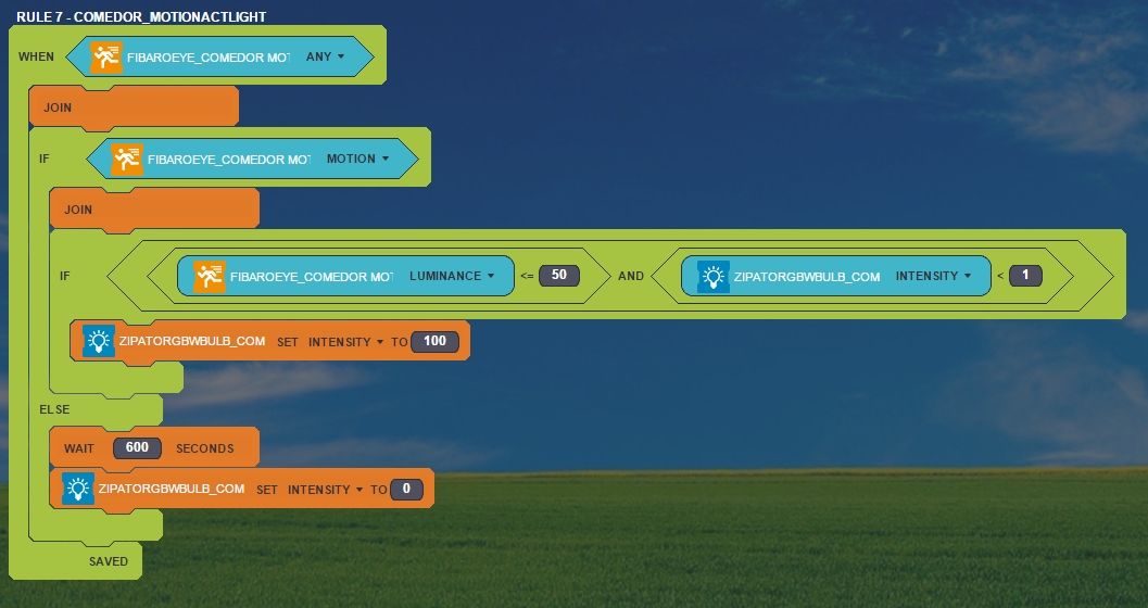

This is an example for the usage of JOIN. This is a motion activated bulb, which goes OFF after the NO MOTION timer expires.

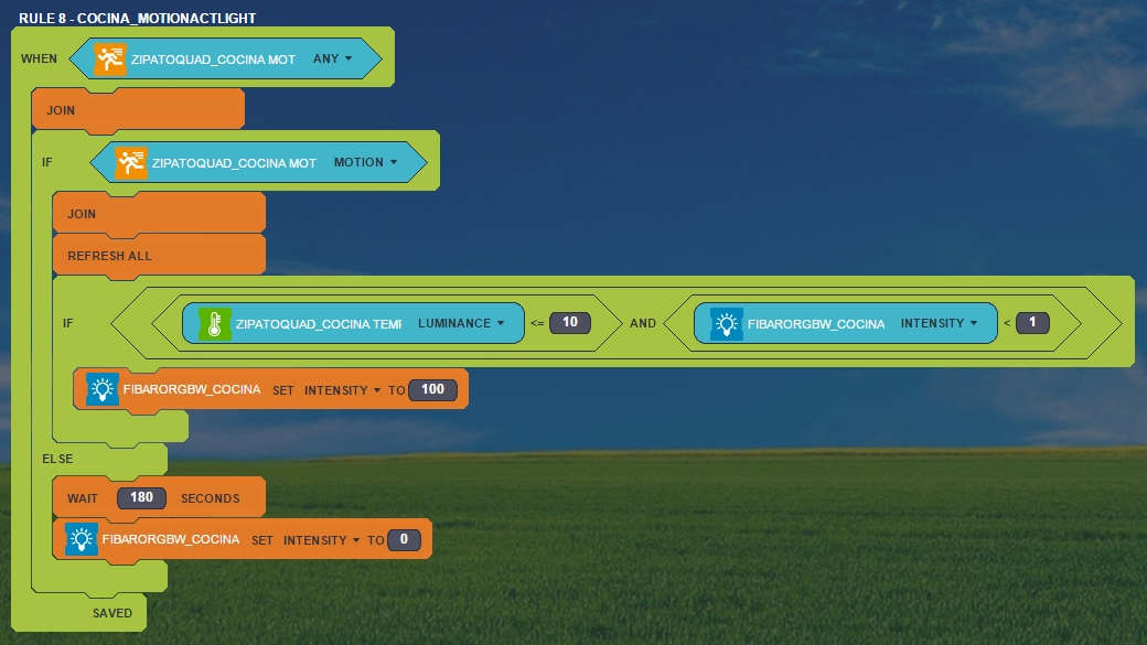

Here you can find the same example with a REFRESH ALL, I do this in this case because I use different multisensor and noticed that without it the rule does not work but after the first motion was detected. I'm pretty sure this is due the way this device works and it's configured, it sends the update of lumination sensor at the same time the MOTION / NO MOTION event is sent to the controller. This way it works since the first time.
