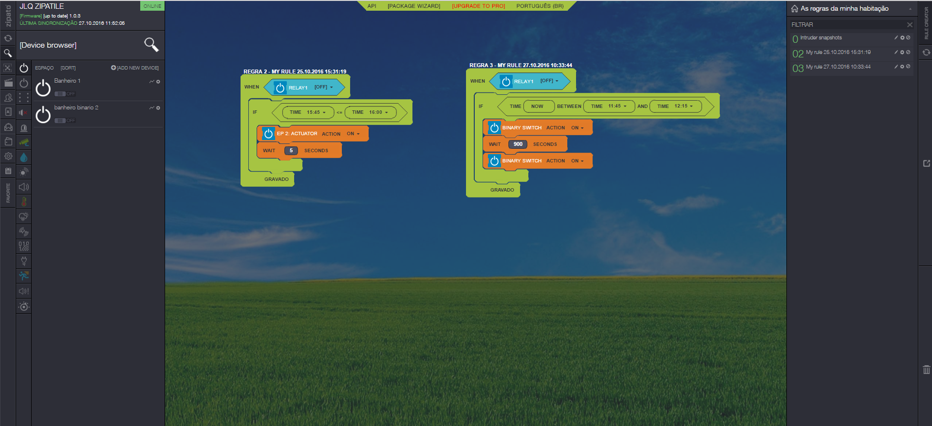

I'm trying to create a rule in my zipatile but I'm not making progress, rule I'm trying to create It's simple got a (Switch Z-Wave Fibaro FGS-211 ) I want when it reaches a time, gives one pulse every 15 minutes, I'm doing some tests, but so far I had no progress could anyone help me?

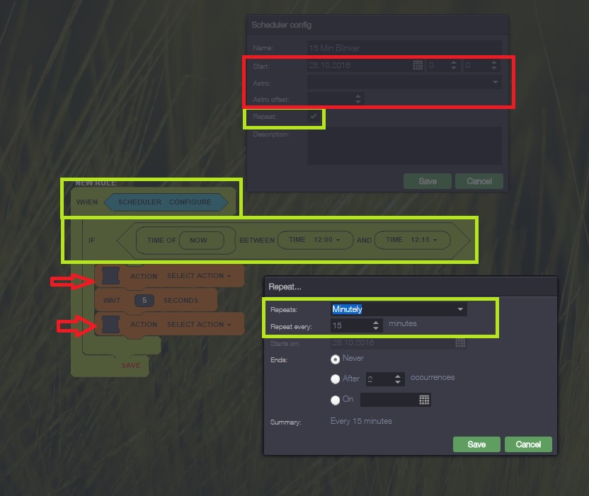

You have to remember rules are based on events. The rules you have set up in the images would only run when the relay changes its state from ON to OFF so unless you manually switch ON and then OFF the relay these rules will only run when the device reports back its state to the controller, which might be outside the time frame you want.
They way I would do it is;
1. Set up a rule using a scheduler for every 15 minutes (all day and everyday, if you want to) that turns ON either a virtual switch or virtual sensor, waits a few seconds, then turns it OFF. For explanation purposes we will call this virtual device "15minblinker".
2. Create a rule based on the ON state of this virtual device to turn ON and OFF the switch. Somethink like;
* WHEN 15minblinker IS ON
* IF TIME OF NOW IS BETWEEN XX;XX AND YY:YY
THEN turn ON switch
WAIT 5 SEC
TURN OFF SWITCH

If you only want it to do it for 15 minutes then you can simply use the scheduler to fire off the rule, then you can use a repeat puzzle with the device state as toggle and a wait block for a couple of seconds. The amount of repeats * amount of seconds for wait should add up to 15 minutes.

find it attached. the scheduler is set up to run every 5 hours every day. You need to insert an actuator to the action puzzne obviously.

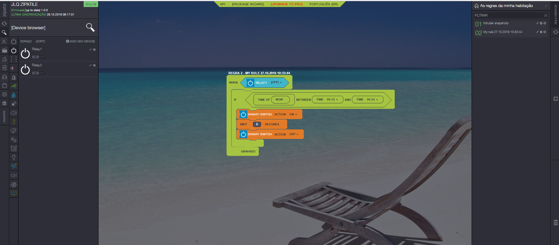

Alberto is right, in the last pics you sent, the first rule will only run a sunset every day, and it will turn the switch on then 5 seconds later turn it off.
The second rule, will only trigger when the relay is changed state into the off position. So when the switch is turn from on to off, it will trigger this rule, then if the time is between 9:15 and 9:30 it will switch the binary switch on wait 5 seconds then off. But if the switch is already off, and the time is between 9:15 and 9:30, it will not run, as the trigger(the relay) is already off.
