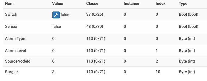

Thanks for your answer. What option is the "option 7" ?
Can you have a look at my screenshot ?
Thanks,
Pierre
You need to use command class CONFIGURATION to set the configuration option 7 to value 128. We do not not how this is done with JEEDOM.

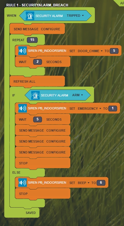

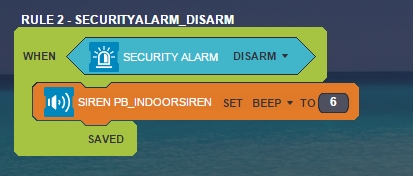

I have a setup like the following and its very similar to what you want to do. I make my siren beep for 30 seconds if the partition is tripped, also beep while arming or disarming. Siren goes off only after 30 seconds of beaping.

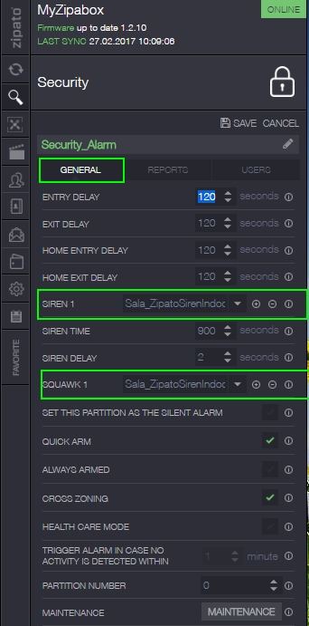

If you are using Zipato Virtual Alarm you can configure what you want in the alarm setting. You can configure the indoor siren as squawk and will beep every time you ARM/DISARM the alarm, regardess how you do it.

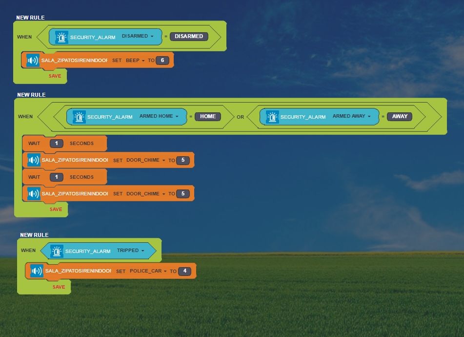

thanks, but i wpuld like to have an alarm sound (i.e. POLICE) and a different sound when I turn on/off the alarm (i.e. door chime)
Michael,
Then you have to use rules, see below.
Thanks. That looks cool. What should I do then in the configuration of the alarm system (sirene/Squawk)? Leave it empty?
Yes, the first two rules would be your squawk (you can put whatever number of beeps or lights) they will only activate when you change Alarm Status.
