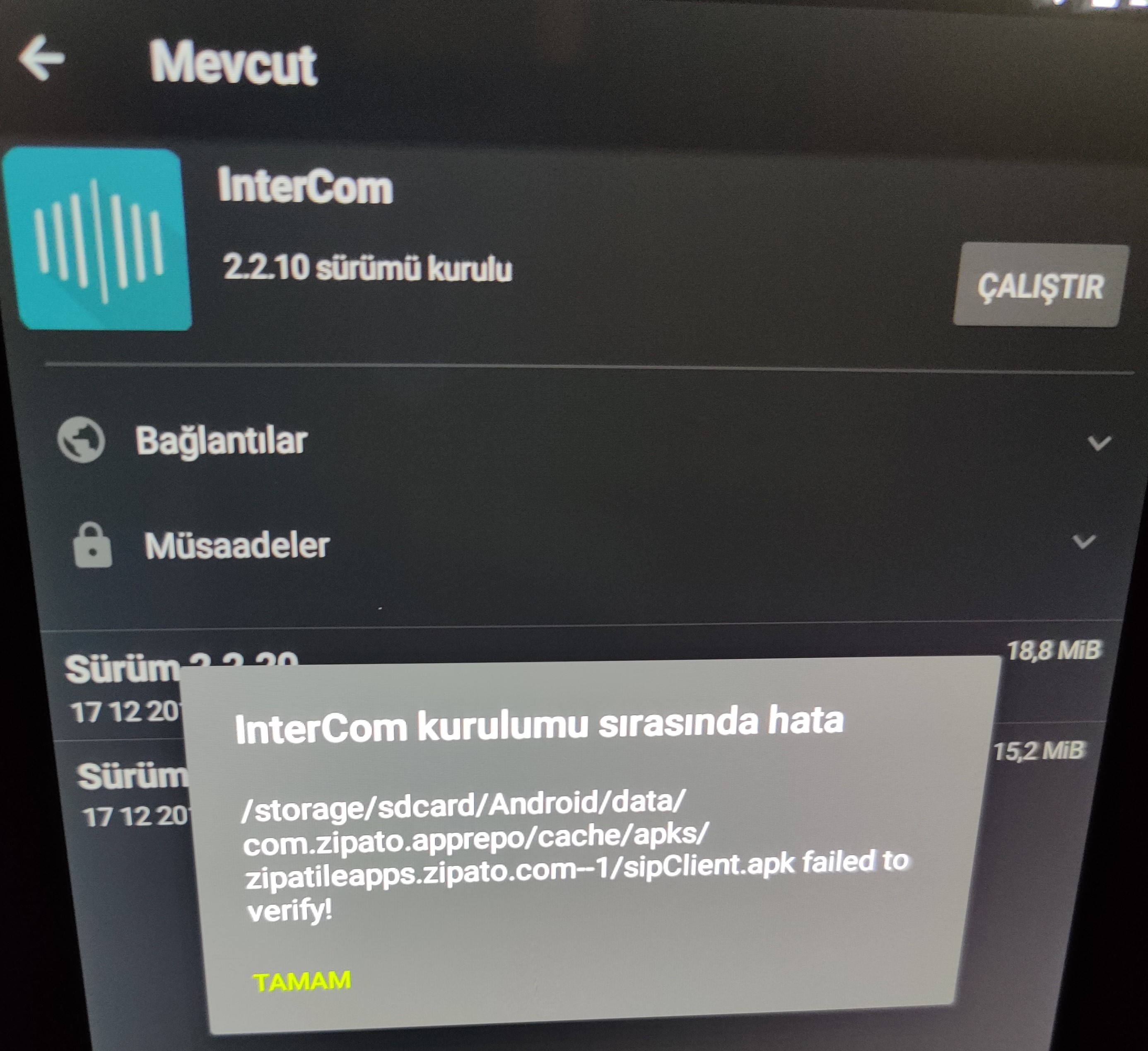

While updating the InterCom App from 2.2.10 to 2.2.20 on the Zipatile v2 then I got an error code. You can see the error message below.
How can I fix & update it?
IMG_20200307_21...
version 2.2.20 is not available on the App repo anymore. 2.2.10 is still official. As I can see this update gets stuck in your cache memory and you should clear data of the App repo application to fix it (Main menu->Applications->Settings->Apps->App repo->Clear data).
