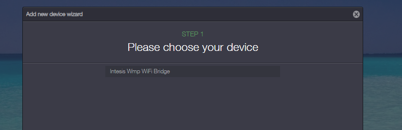

Intesis WMP wifi bridge Inclusion?
In Progress
Has anybody tried this?

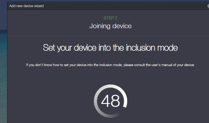

There are no instructions anywhere on this process and the IntesisHome WMP wifi devices do not have an "inclusion" mode as asked for by the Zipato system.
Or is this for Intesis Box modules, and if so, what type, Modbus/Bacnet/Lon?
I would like to inform you that Intesis WMP Gateway is supported in Zipato platform.
Please check the following:
- Intesis is paired with its router
- Zipato controller is in the sam esubnet with Intesis Gateway
- Zipato controller has the latest beta version
