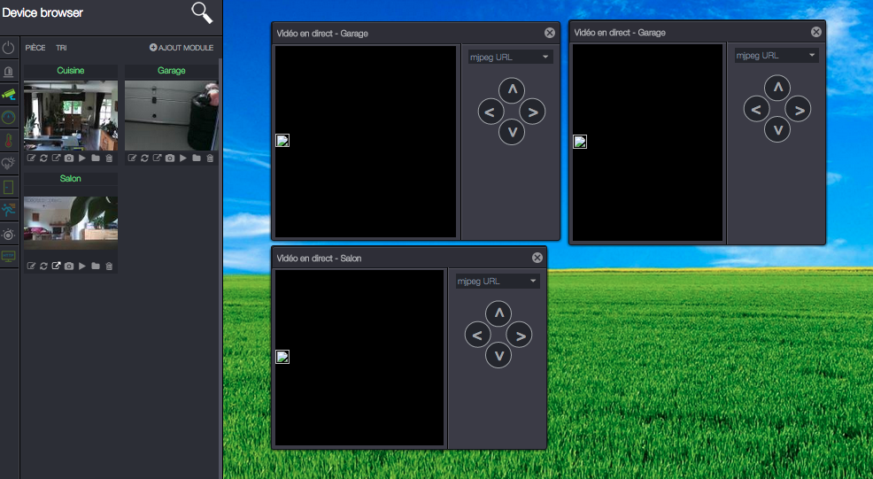

The cameras operate in FTP mode, but nothing works in live mode.
I tried on firefox, explorer and Chrome, but no positive result.
With the old version it was possible without problems.
