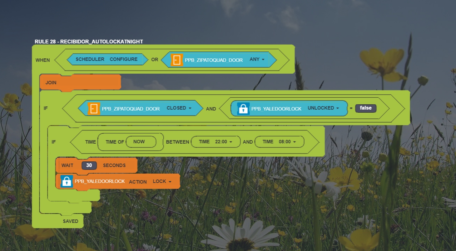

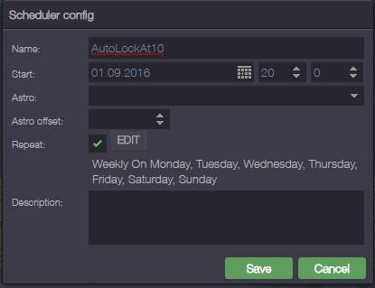

I have Yale Z-wave doorlock and a zipato multisensor quad in the same door. My objective with the attached rule is to automatically lock my door under two circumstances;
1. It is 10:00 pm AND the door is already closed AND my lock is currently unlocked.
2. If it's between 10:00 pm and 8:00 am, and I open the door and remains locked for 30 seconds and my lock is currently unlocked.
The rule works but it locks the doorlock every time I open/close the door. It is not following the TIME BETWEEN puzzle. If I remove the scheduler from the OR condition, the TIME BETWEEN puzzle works.
Just one idé but try to put the schedule and time constrains in the if block?
Then the rule runs every time ther is a change in the dorlock status or try to use other triggers.
The schedule I think is only trigger 20:00 and then it does not trigger.
I also think the time constraint should be in the if block. Not useful in the when block. But I am really not sure.
Worth a try!
Best regards Jacob

Alberto,
I too am experiencing issues with schedulers.
My suggestion is that you remove the scheduler from the OR condition and instead have the schedulers in separate, stand alone WHENs, where they activate a virtual switch, and that you use this virtual switch instead in your OR clause.
Robert

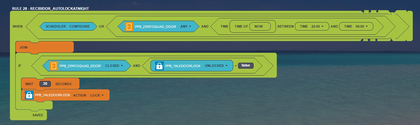

Hey guys,
Thanks for your answers. Indeed I thought about both solutions you're proposing, I tried Jacobs and it works in one rule, see attached. Also I use Robert's for more "generic" schedulers like Sunset/Sunrise, Reboot Check, Hourly Check. But honestly I just couldn't understand the issue on my first rule, looks like the schedulers used on AND or OR puzzles always are true, if you remove the OR and the scheduler or the time constrain it works with either/or functionality correctly from the first rule.

Robert,
Thanks for sharing your thoughts. I'm also a software developer, but for industrial automation, so I'm also trying to figure out how the processor works so this information is appreciated since I'm not familiar with web based programming languages.
This is funny, the first rule works all the time without considering the time restrain. Scheduler works (rule is triggered at 10:00 pm) and also everytime I close the door regardless of the hour. It's like the time restrain RLO (Result of Logic Operation) is always TRUE.
Seems like the scheduler is not the problem, I got it working moving the time restrain inside the WHEN, and only left the Door Sensor OR Scheduler to trigger the rule. See my previous comment for snapshot of the rule.
