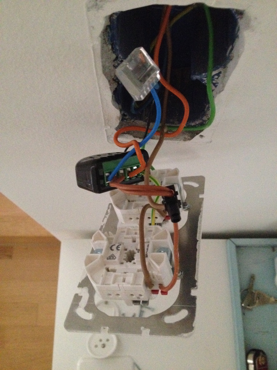

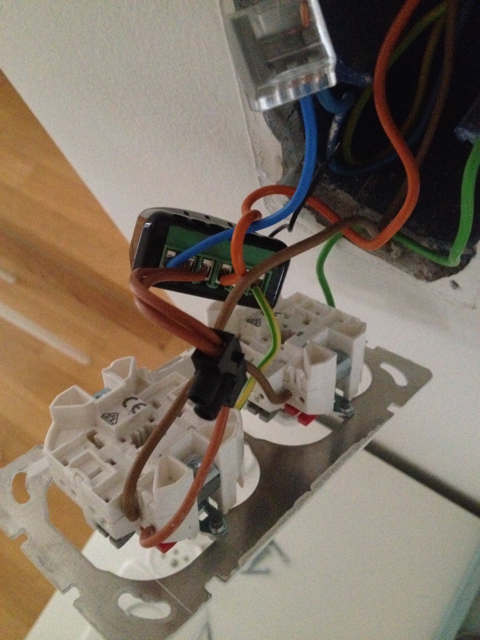

Hi everyone,
first of all thank you very much for this wonderful system, I really enjoy my Zipabox so far.
However, I have one small issue with my Fibaro Relay Switch. We have lights in our hallway that get controlled with two switches, I have installed the FGS-212 in one of these switches. The physical switches work fine if I change the configuration to "Toggle", but from the Zipabox interface I have to sent the toggle or on/off commands twice to trigger the change. If I only toggle once in the Zipabox I get a loud hum from the fuse box in our apartment and the second toggle turns the light on/off. If I press and hold one of the physical switches I get the same hum in the fuse box and the lights turns on/off if I release the hold. This makes me believe it is a configuration and not an installation error. Theoretically I could just always fire the toggle command twice, but that would also mean that I will never receive the right status of the lamps.
Can anyone help me with that?
Best regards and thanks in advance,
Theo.

Pictures of cables and installation?
Here are two photos of the installation.
