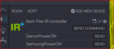

It have not been able to reproduce any learned command to be sent though the Zipato UI to the itach flex to send IR codes.

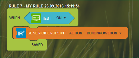

Just to clarify, pressing the send button works, but creating a rule with it will not send the command.
can you create a virtual switch in the scene to trigger the ir commands instead. I know this is a work around, but does it work?
For me it still does not work. if I press SEND on an individual command that works perfectly.
Executing a command in a RULE does not work. I have had instructions from Vedran and follwed them all exactly. Still does not work.. :-(
3
yeh, this is how mine is at the moment.
