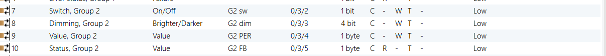

1-see the ETS parameters pic first you will choose these parameters from ETS

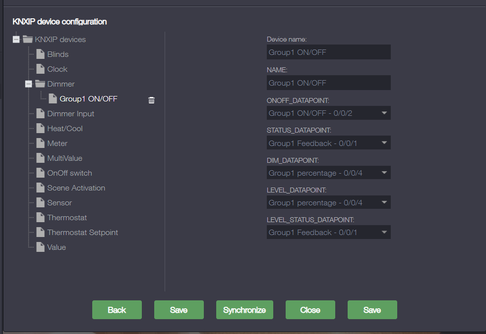

2- see knx Dimming Zipato Config after renaming it on knx and get the KNX.esf file then choose the parameters that you have renamed it

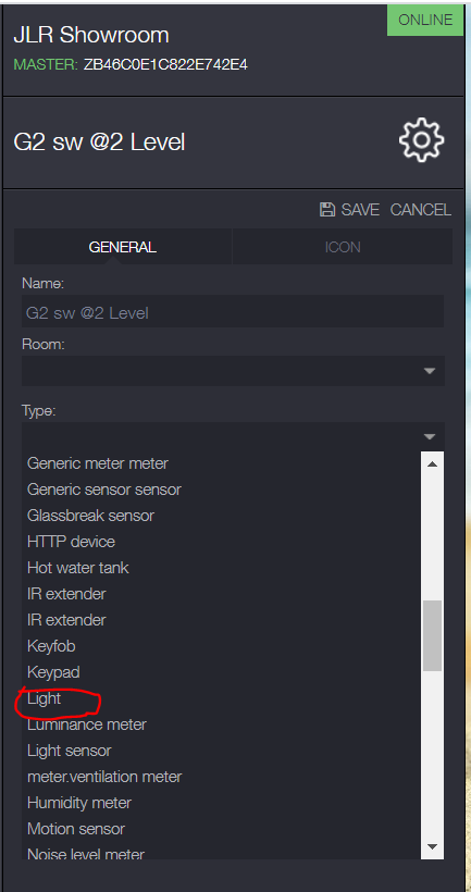

3-After that see Zipato sitting 1 and 2 pic reload then your dimmer is ready
