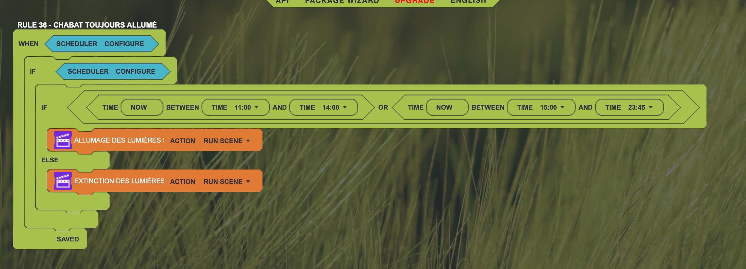

I would like to find a rule so that the light remains on even if we turn off the switch.
I found a rule that is renewed every minute.
I would like for example that the light remains on from 8 p.m. to 11 p.m. every Monday,
here is the rule I made but it doesn't work
Someone would have any idea

you can create rule which will switch lights on for any state of your switch.
and to be sure that the light stays on (or off) even if you switch on the switch,
do you have a solution with a photo if possible
I have no photo but I assume that you can create rule which simple switch on for both cases - if switch is switched on or off. For your information, rule is triggered for any changing event so if someone switched off rule will be activated and it can switch on back.
