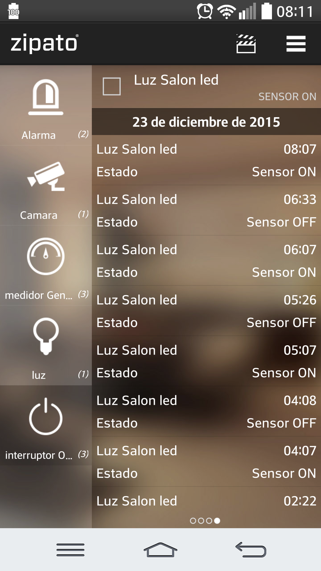

I've installed the micromodule switch double and it goes on suddenly without any intervention from myself.
Could you tell me, what are the reasons?

It's kind of weird. I've got only the double switch and the RGB light. Nor rules neither groups or associations. The funny thing is that it's set on every hour and seven minutes. Here is printed screen...
