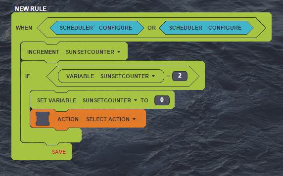

Hi, you can use a rule like the one in attached image.
In that scenario you have to set the first scheduler to be triggered every day at sunset and the second one to be triggered every day at 17:45.
I use a similar rule to open shutter every morning ad sunrise or at 7:00 (if sunrise is before 7:00) and it works fine.
Let me know if it works for you.
