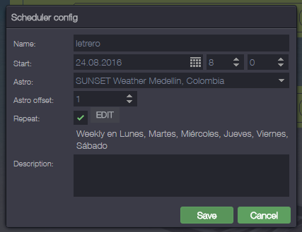

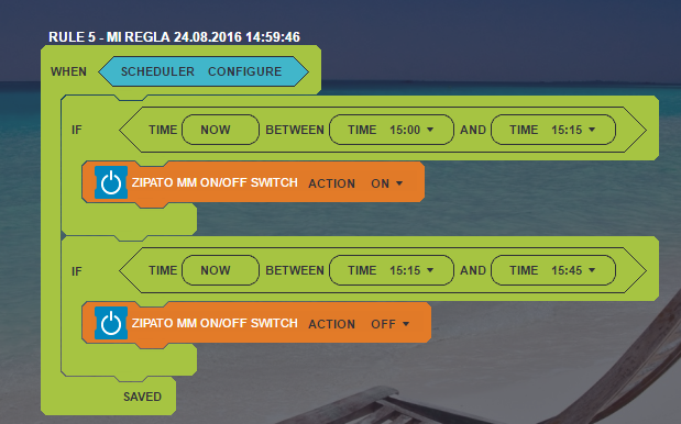

attached photos of the rule and scheduler settings
I think you should remove astro and and astro offset values. If you want the timer to trigger the rule every hour, I think you need to change the Repeat (click edit) and set the start time, and the schedule to Hourly and repeat every 1 hour.
As Marius said, in the scheduler you either use the astro (with or without the offset in minutes) or you use the time based trigger, but never both.

remove the scheduler. You are asking the rule to run at 1 minute after sunset, and if the time is between 3 and 3:15pm. Not much of a window there. Either have the run run on the scheduler, or the time sensor.
I do not understand why the 2 rules to either turn the light on after sunset within a 15 minute period or off in a 15 minute period after this.

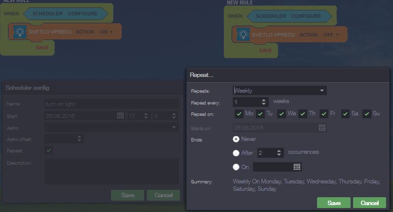

here you go. The actual scheduler is for the "turning on at 5". The second rule will have same scheduler, just set at midnight (00:00 or 23:59).
Definitely works. Dont forget, dont use any existing puzzle piece from existing rule, use all new puzzle pieces.
