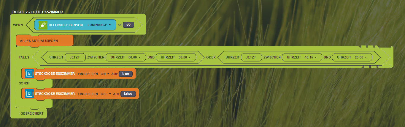

Hi , I have a problem with this rule .
1. When the brightness before the time already is <= 50 , then the light does not turn on . Once I change something by the brightness in the room , the socket switches ( at which the light hangs) .
2. If, within the time for a long time ( as long as I could not figure out ) the brightness does not change ( constant e.g. 30 ) , then the light turns not back out .
How do I get it out , which makes the rule a direct query of the value .
P.S. I use a Zipatile and the internal brightness sensor .
Is there a possibility to use an average value ?
Greetings Thomas
