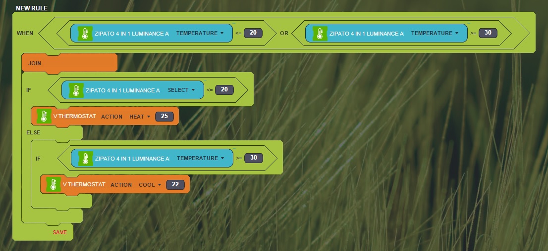

I wonder if someone can help me making a rule in rules creator for my heather to start at a certain temperature by a tempsensor. Also the opposit to stop the heather at a certain temp.

Try this. i am sure there are other ways to do this also
Adrian for yor advise, i have tested it and it worked.

Halo Adrian, do you have a solution if i want to start the rule at 17.00 and stop at 22.00
Whats wrong with the virtual thermostat pro? it is there for exact same purpose. did you try it? Btw, Adrian, great rule. I will try it when have opportunity.
