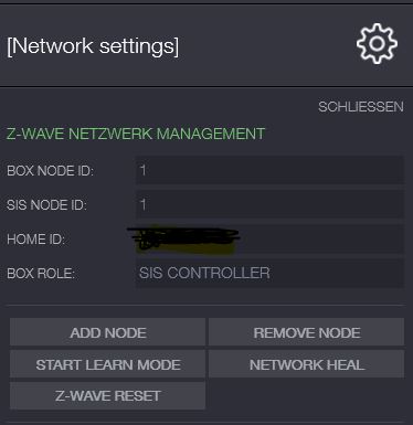

Found it. They moved it to the settings part of the Zwave network.
It is located in the device manager tab now, next to the z-wave network name there is a "cog" icon
Sometimes it is good to update your network if you change device locations, or add devices to the network but not in the intended place. It can also help to determine or remove dead spots in the networking.

@Adrian: I am sorry, but I am not sure whether I understood you right. Whta do you mean by "cog" icon? Ist the NETWORK HEAL function the right function the rebuild the mesh network?
