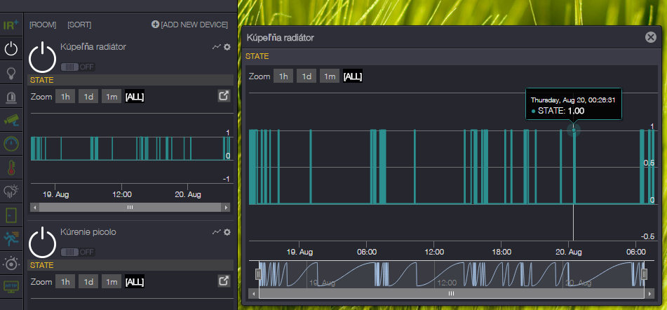

We installed 12 micro module double switches to control LED lights in a large office space. We are facing the problem of the lights getting ON and OFF autonomously and randomly without our control. We installed diodes to block current from flowing from the wall swich into the S1 and S2 lines of our module (as recommended by Milan from support) but still the same problem exits. What can we do?

Could this switch came originally from Qubino? I have one Qubino dimmer, which does same time to time.

Basically there must be something wrong with the firmware as it turns on and off randomly. I have no rules, no other relations to my switch, still it life is random, where it should be off.

I just solved this problem by making a physical separation between the switches. Instead of the original customer setup where all units where in the same rack we installed one switch ineach room.
The other variation was the temperature since the original room where the rack was installed was not well aircpnditioned while now inneach room the A/C is good.
Wael
I have the exact same problem. I have one micro module per room and many of the rooms dont have any rules attached, but still i get these incidents where lights turn on during the night.
