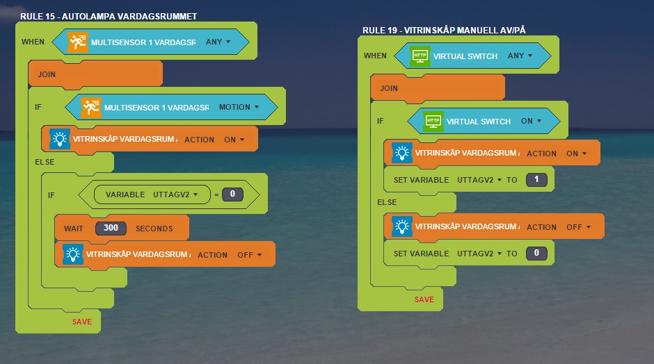

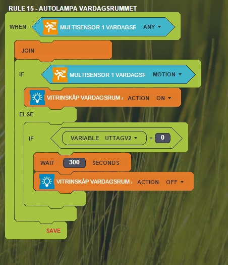

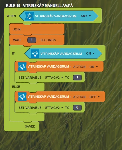

What I used to achieve this was:
1) A Nexa wall plugg to switch the light on/off.
2) A virtual switch.
3) A variable to indicate "manual" on/off.
4) A rule for manual on/off via the virtual switch (all rules that does a "manual" on/off needs to set the variable to the corresponding state).
5) A rule for auto on/off.
NOTE: It's hard to see in the pictures but the light is always on/off by the NEXA switch, not by changing the state of the virtual switch.
I have attached the rules as pictures below.
But what exactly is it that set it in auto mode?
Can you show the name of the Virtual switch so I can see how it corresponds with the rules?
And do you have other people around you that controls the lights and how do this change the lights back to auto and the other way around?
I have my wife that hates automation and only wants to control lights with switches and me that was everything to be automatic.
I made a mock virtual switch so that it's easier to see. the virtual switch and the nexa wall plugg has almost the same name :-)

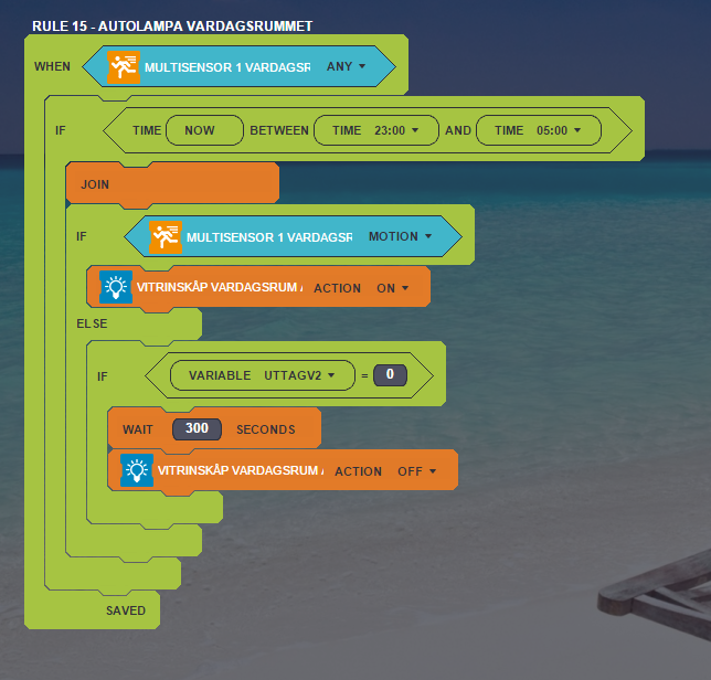

I want the off function to turn of the light and keep them of 30 seconds until next motion and I want the motion to go to latest value and if I press the light switch the light stays on to the latest value.
Guess it is more complicated with a dimmer. And after time 00:00 motion should turn on to 15% but after 00:04 automation go back to normal motion again.
